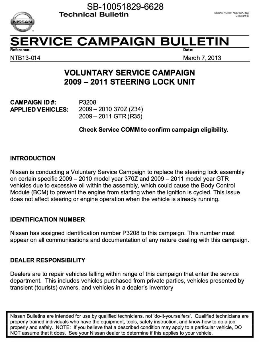

Ebized Posted January 31, 2018 Share Posted January 31, 2018 (edited) You will find the answers on this thread at posts 37, 127 and 157, as regards those 370 models which were included in the recall and that was for those made up to the end of 2010. See: http://ww2.justanswer.co.uk/uploads/MU/05muranosl/2014-01-30_155727_steeringlock.pdf 2013+ 370 models do not have the steering lock fitted, so the 'issue' should not apply....unless someone knows otherwise. But it appears some 370's between 2011 and 2013 have also been affected but not covered by the original recall.....Whether a goodwill payments are still being paid, I suspect might be doubtful. For the pre-2013 models the advice to avoid being stuck is remove the appropriate fuse - but make sure you follow the correct procedure. (There is guide somewhere on here)**. I'm sure I recall at least one owner saying their replacement lock had failed! So doing the fuse trick is the safest way to avoid a very nasty bill and given Nissan decided in 2013 the locks were not necessary and has not affected the Thatcham security (for insurance purposes). EDIT: Guides here: NOTE: THE FOLLOWING IN BLUE IS LIFTED FROM OTHER FORUM POSTS SIMPLY TO HOPEFULLY HELP MEMBERS ON HERE. A picture of the fuse that matters (the fuse box is next to the battery): You have to pull the fuse after you get the SLU to let the car go to ON or ACC. If the SLU is not making the microswitches properly, it does no good to pull the fuse. If, like the OP, your lock try wiggle shaking and banging the crap out of it to jar it loose first. Blow a heat gun/hairdryer on it if its cold etc. You only need it to disengage one last time. Some have luck tapping it with a little hard object like a SMALL hammer or screwdriver. My understanding from reading various threads over the pond is that over-lube inside causes failure of some plastic bits and the little gear teeth fail then get hung up. Tapping might get it one last time, then once its unlocked you can pull the fuse and save a lot of money and a wasted day or two. Edited January 31, 2018 by Ebized Quote Link to comment Share on other sites More sharing options...

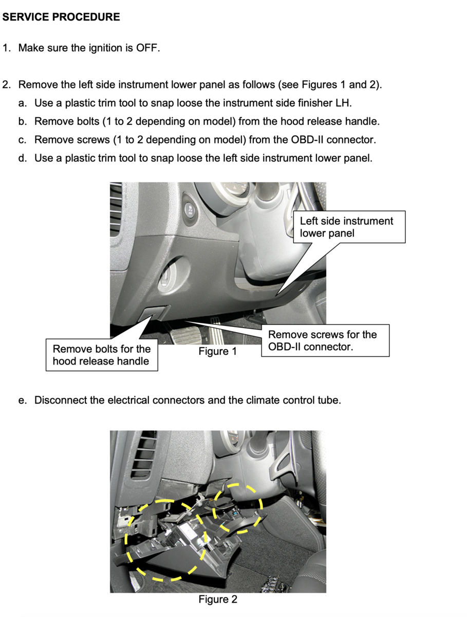

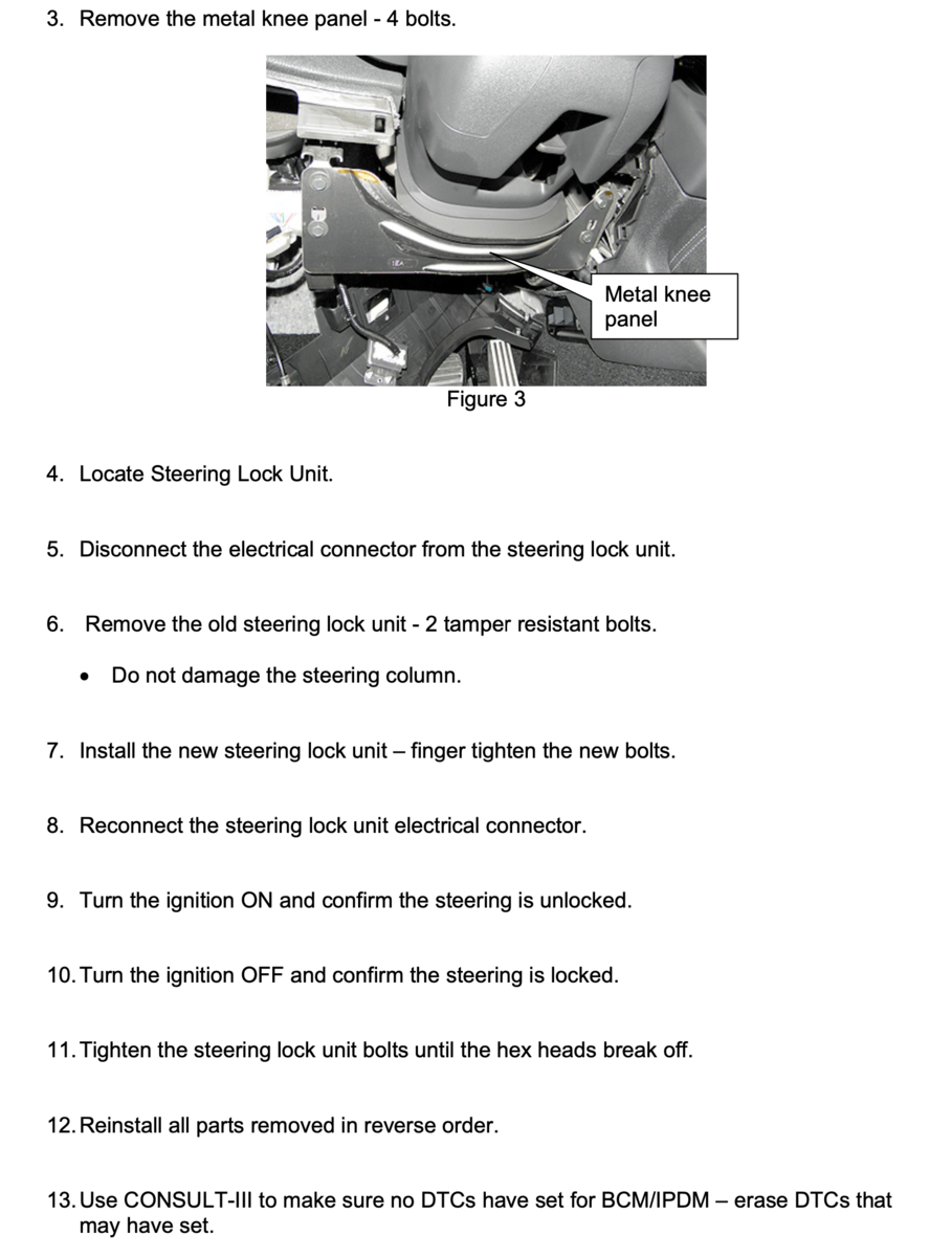

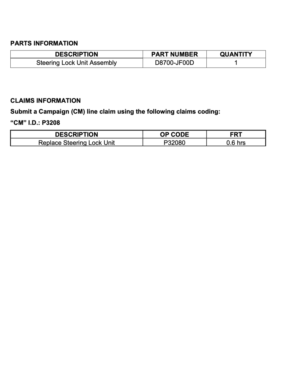

Adrian@TORQEN Posted June 19, 2020 Share Posted June 19, 2020 Some updated info to help people coming here from search engines: VSC / Recall issued by Nissan on 28th March 2013, campaign ref. P3208. “On Thursday 28th March 2013 the campaign (ref. P3208) was loaded onto dealer computer systems. Cars that qualify for the campaign are early 370Z and GT-R models which have steering locks 48700-JF00B and 48700-JF00C. These would be replaced with the most recent item 48700-JF00D.” There is no time limit on the campaign and there is no upper limit on the mileage of the car. I've attached a photo with how mine was looking like before being replaced, that's on the 370z. The part number you need is: D8700-JF00D, this supersedes, 48700-JF00A, 48700-JF00B, 48700-JF00C, and 48700-JF00D. 2 Quote Link to comment Share on other sites More sharing options...

Adrian@TORQEN Posted April 3, 2024 Share Posted April 3, 2024 Wrote an article here about it: https://www.torqen.uk/content/19-steering-lock-unit-failure-fix-in-the-nissan-370z-z34-and-nissan-gt-r-r35 Search for 370z windows reset procedure on YouTube 1 Quote Link to comment Share on other sites More sharing options...
