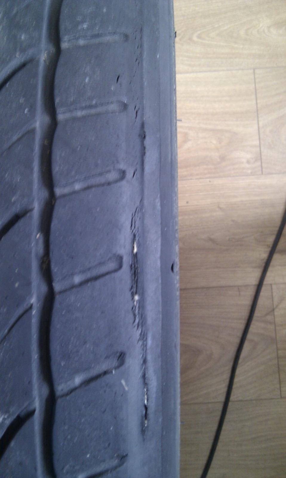

KosmiK Posted April 13, 2013 Share Posted April 13, 2013 Hi all, hope this is in the correct section, apologies if it's not. I bought a 53 plate 350z a month ago, and everything seemed great, until today that is. I don't know why but while i was outside I felt the need to reach around the tyre (something I now wish I'd done before I bought the car). Upon doing so I noticed a hard edge, instead of a smooth one (shown in the pics), and have no clue how it's happened. I thought I'd checked the tyre tread before buying, but obviously not thoroughly enough. MOT was only 500 miles ago, so I'm guessing these wheels weren't on for it. The tyres on the front are 245/30/20R Falkens, and have decent tread remaining in the middle and outside. I think there are spacers on too, and the car's been lowered. Can anyone shed some light on what's happened here? Nothing in the wheel arch looks like it's been catching/rubbing, but the fact that it's just the very edge of the tyre seems strange to me. The passenger side wheel isn't this drastic, but it's still worn all the way though. Thanks in advance for any advice. Quote Link to comment Share on other sites More sharing options...

KosmiK Posted April 13, 2013 Author Share Posted April 13, 2013 (edited) Thanks for the replies KC350Z. No advisories on the last MOT, but the owner did say he also had the original wheels, which I'm now guessing he put on for the MOT. No specs on the lowering springs or spacers sadly. All I can say for sure is the springs are green and the spacers look 20-25mm. Pic attached of the wheels on the car too, doesn't seem unreasonably low to me, wear is on the inside of the tyre but it doesn't seem to rub anywhere. Pic was too big to attach, hopefully this link work. http://img811.imageshack.us/img811/4442/imag02471.jpg Edited April 13, 2013 by KosmiK Quote Link to comment Share on other sites More sharing options...
JetSet Posted April 13, 2013 Share Posted April 13, 2013 Welcome, best to use photobucket to upload your photos. That looks like a rubbing issue to me, the only thing I can think of is that it's catching the part that comes down from the suspension because it's been lowered too much. Usually, they rub on the outside of tyre on the wheel arch. Pete Quote Link to comment Share on other sites More sharing options...
Ebized Posted April 13, 2013 Share Posted April 13, 2013 I doubt that is the tyre rubbing on anything as it would be the whole way round. Given how worn the tyres are and you can see the canvas below I wonder if this the tyre starting to split, shall we say been put under a lot of sideways loading As for adding pics, uses a photobucket/flicker or what-have-you host and copy the URL into the little green image box when you use "more reply options" Quote Link to comment Share on other sites More sharing options...
JetSet Posted April 13, 2013 Share Posted April 13, 2013 Given how worn the tyres are and you can see the canvas below I wonder if this the tyre starting to split, shall we say been put under a lot of sideways loading Yes, I see it now. Check the speed rating on the tyre sidewalls. Also check the pressures, should be 35 psi. Pete Quote Link to comment Share on other sites More sharing options...
KC350Z Posted April 13, 2013 Share Posted April 13, 2013 ok try putting to full lock both ways and check its still clear as it will drop a little bit more when doing this and as above check not rubbing on suspensionwhen full lock and also any wear on inner arch but i recon suspension if any Quote Link to comment Share on other sites More sharing options...

KosmiK Posted April 13, 2013 Author Share Posted April 13, 2013 The suspension was my first guess but doesn't look clean/worn like it's been rubbing constantly. There's a good inch between the tyre and the suspension having just checked, is the suspension likely to travel that much during normal road use? Will go check the gap when it's on full lock now. Both tyres are worn on the inside by the way. Thanks for all the replies so far. Quote Link to comment Share on other sites More sharing options...
KC350Z Posted April 13, 2013 Share Posted April 13, 2013 wont travel very much lowered Quote Link to comment Share on other sites More sharing options...
KosmiK Posted April 13, 2013 Author Share Posted April 13, 2013 I didn't think it would. Just checked on full lock both ways. Tyre is no where near the suspension. I'm thinking I'll just have to get new tyres fitted and keep an eye on them. Maybe the seller just stuck worn tyres on to get rid of them or something, and the damage happened on another car or something beforehand? I've no idea. Quote Link to comment Share on other sites More sharing options...
KyleR Posted April 13, 2013 Share Posted April 13, 2013 (edited) If it was rubbing that deep into the tyre you would certainly know about it. Sounds like you have tein springs which are only a small drop, 17mm rear 14mm front if I remember correctly. Any details on the wheels? 20 inch diameter but how wide? What offset? Edited April 13, 2013 by KyleR Quote Link to comment Share on other sites More sharing options...

JetSet Posted April 13, 2013 Share Posted April 13, 2013 No clue sorry. All I know is they are Vertini Hennessey's. I've just taken off some 20 inch Vertini Hennessey's although my car isn't lowered. Unless the back of the wheels have been drilled out you can't get hubcentric spacers on them without fitting a small spacer first. The ET on them is 35 and they're 8.5J. I had the occasional rub, I presumed it was on the arch rather than the suspension and I've just looked at the tyres and can't see any damage. Pete Quote Link to comment Share on other sites More sharing options...
tony.r123 Posted April 13, 2013 Share Posted April 13, 2013 That looks like heavy rubbing to me, i'm sure you would have heard it by now Quote Link to comment Share on other sites More sharing options...
KosmiK Posted April 13, 2013 Author Share Posted April 13, 2013 No clue sorry. All I know is they are Vertini Hennessey's. I've just taken off some 20 inch Vertini Hennessey's although my car isn't lowered. Unless the back of the wheels have been drilled out you can't get hubcentric spacers on them without fitting a small spacer first. The ET on them is 35 and they're 8.5J. I had the occasional rub, I presumed it was on the arch rather than the suspension and I've just looked at the tyres and can't see any damage. Pete I'm pretty sure they are hubcentric spacers, but I wouldn't know the difference if there are other types. There was what looked like little plastic rings inside the wheel though. That looks like heavy rubbing to me, i'm sure you would have heard it by now Haven't heard anything out of the ordinary, I don't think. Maybe the wear didn't happen on this car/this setup. Time will tell once i get new tyres I suppose. Quote Link to comment Share on other sites More sharing options...
JetSet Posted April 13, 2013 Share Posted April 13, 2013 This is a picture of a tyre that had a blow out while I was driving it. As you can see the damage is on the inside of the tyre and right at the edge. This was caused by under inflation, I suspect a slow puncture as the car felt a bit odd about 5 miles before it blew. If you look at pictures of damaged tyres it would seem that most of them blow on the inside of the wheel which must be the part of the tyre that takes the biggest load. Pete Quote Link to comment Share on other sites More sharing options...
