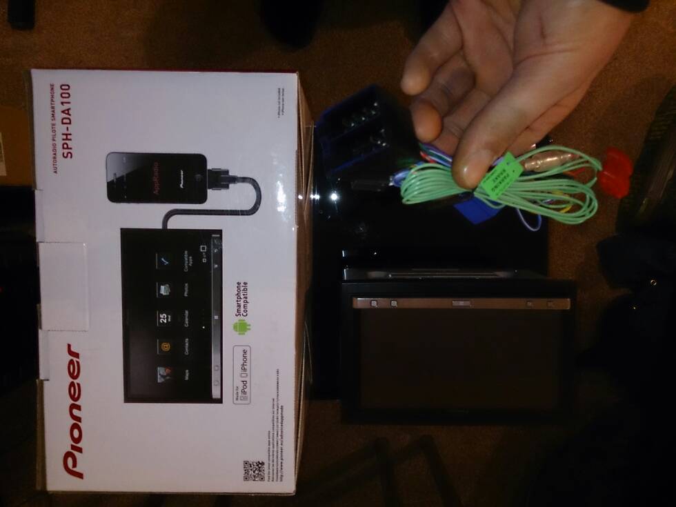

bpmjames Posted April 4, 2013 Share Posted April 4, 2013 But what else do I need to make it fit in the car? Sorry for the boon question guys. All I have is the stereo, iso lead and iPod leads etc. Do I need a shroud? Wiring? Here's a pic. Thanks Jim Sent from my C6603 using Tapatalk 2 Quote Link to comment Share on other sites More sharing options...
Ekona Posted April 4, 2013 Share Posted April 4, 2013 Second Sticky at the top of the forum tells you all you need to know. Quote Link to comment Share on other sites More sharing options...

spursmaddave Posted April 10, 2013 Share Posted April 10, 2013 Try here http://incartec.co.uk/Manufacturer/Model/Brand/Device/Radio/Browser.aspx Quote Link to comment Share on other sites More sharing options...

EvansJD2112 Posted April 10, 2013 Share Posted April 10, 2013 +1 for Incartec Excellent website that makes getting the required 'bits' really simple. Quote Link to comment Share on other sites More sharing options...

bpmjames Posted April 11, 2013 Author Share Posted April 11, 2013 I have the stereo fitted loosely at the moment while i wait for my surround to turn up from incar, theres not a lot of space for wiring behind the stereo is there?! Sent from my GT-N8010 using Tapatalk 2 Quote Link to comment Share on other sites More sharing options...
bpmjames Posted April 11, 2013 Author Share Posted April 11, 2013 Also guys i need to splice into the handbrake on the live side for my stereo to work correctly but can i just splice into and switched live? Sent from my GT-N8010 using Tapatalk 2 Quote Link to comment Share on other sites More sharing options...
Fluke Posted April 11, 2013 Share Posted April 11, 2013 But, does it need the additional surround to fill the gap around the edge? Quote Link to comment Share on other sites More sharing options...
