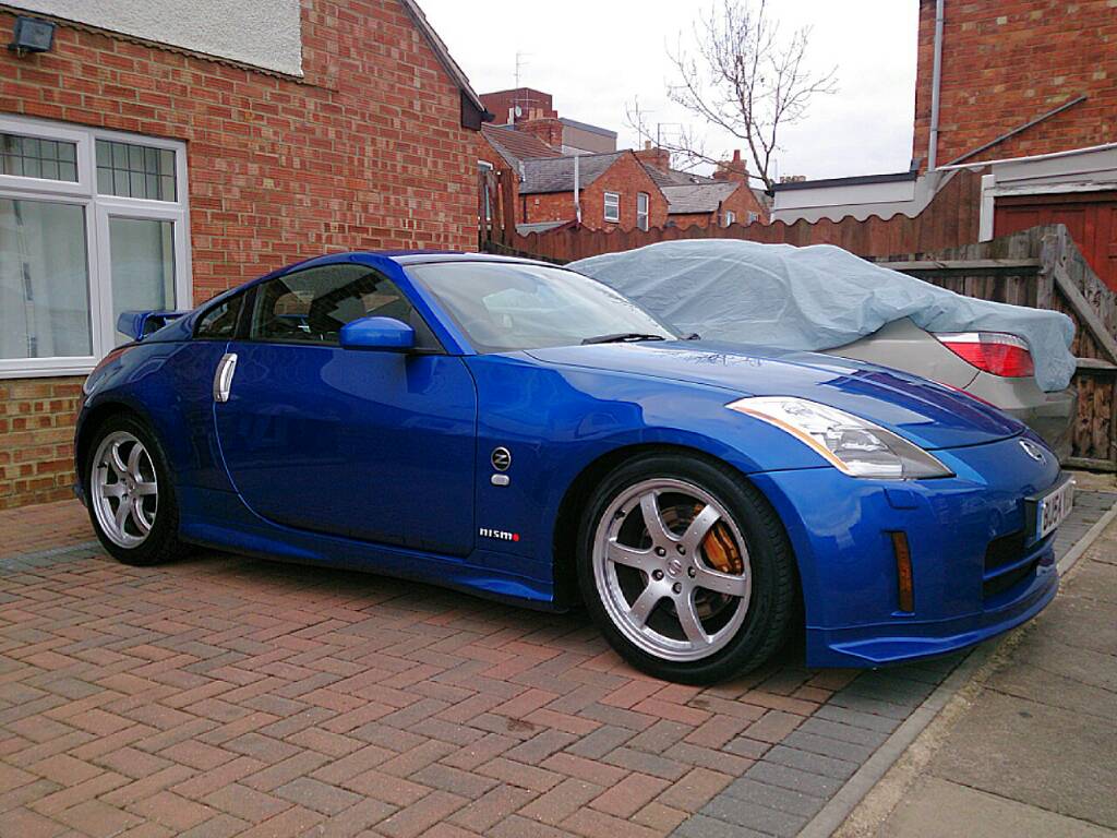

bpmjames Posted March 31, 2013 Share Posted March 31, 2013 Hi guys, i picked up my new zed yesterday, overall im happy with it but i think theres a few things i need to sort out. One problem is the steering doesnt self centralise (sp?) and it feels quite heavy. Is this likely to be a steering rack problem? Anyway heres a couple of pics. Its a 54 plate with 72k miles Regards Jim Sent from my GT-N8010 using Tapatalk 2 1 Quote Link to comment Share on other sites More sharing options...
MITZ@CougarStore Posted March 31, 2013 Share Posted March 31, 2013 Congratulations on the purchase, Jim, are the tyres inflated to the correct pressures... Quote Link to comment Share on other sites More sharing options...

Will370z Posted March 31, 2013 Share Posted March 31, 2013 Welcome,great looking car you have there and will look fantastic in the sun, if it ever comes out. Steering is heavy in the zed but definitely check the tyre pressue, a slight drop and it makes a noticeable difference Quote Link to comment Share on other sites More sharing options...

madmikester Posted April 1, 2013 Share Posted April 1, 2013 car looks amazing as for the steering when i got mine it was heavy i bleed the system and got a lot lighter all you need to do is turn the car on remove the power steering cap and turn the steering wheel from one lock to the other keeping it at each lock for 3 sec did mine for a few min and made it much lighter hope this helps Quote Link to comment Share on other sites More sharing options...
