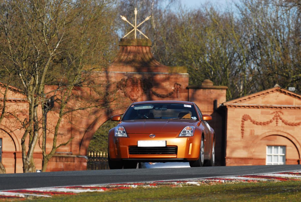

Bergwerk06 Posted March 3, 2013 Share Posted March 3, 2013 Completely standard 350Z everything as per road spec- completed first Oulton Park trackday today (March 2nd) Surprisingly competent especially as most others had fully race prepped toys but the brakes let it down- almost on fire after 4 hard laps as i've never seen as much smoke coming out from the wheels before- so wish list now runs--- Essential- Mintex pads, EBC Turbo groove discs Desirable- Toyo R888s, Suspension- ??? open to suggestions Desirable but not critical- lighter flywheel and competition clutch Overall though brilliant fun- heavy though and needs a 2.5 gear as 2nd and 3rd were both wrong for Foulstones and Island Bend (2nd too low and 3rd too tall) Quote Link to comment Share on other sites More sharing options...
