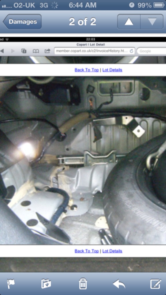

Jmanji Posted March 3, 2013 Author Share Posted March 3, 2013 Ok can anyone tell me is there a rear back quarter straightening tool, I have access to panel hammers? Or should it be pulled straight by a garage? Here's an inside view of the damage Quote Link to comment Share on other sites More sharing options...
Keyser Posted March 3, 2013 Share Posted March 3, 2013 (edited) I can't see enough from the pic to work out the extent of the damage - the outer wing can be pushed out from the inside or "pulled" from the outside when access is limited. 2 ways to do this with a slide hammer one is with glue on ends the other is to drill and bolt/rivet holders onto the panel then attach the slide hammer - it's skilled work as the metal stretches when it is bent and you can end up with bulges. Heat can also help but experience is what is require here. If the panel is really bad it can be cut away and replaced. If any of the inner body work is creased around the suspension line it should be pulled out with a hydraulic ram, but preferably it needs to go on a jig to be sure the whole car is straight and true - unfortunately jig time is very pricey. see http://www.youtube.com/watch?v=vjGArdhEZbY at about 1min 20 sec Hope that helps Edited March 3, 2013 by Keyser Quote Link to comment Share on other sites More sharing options...
