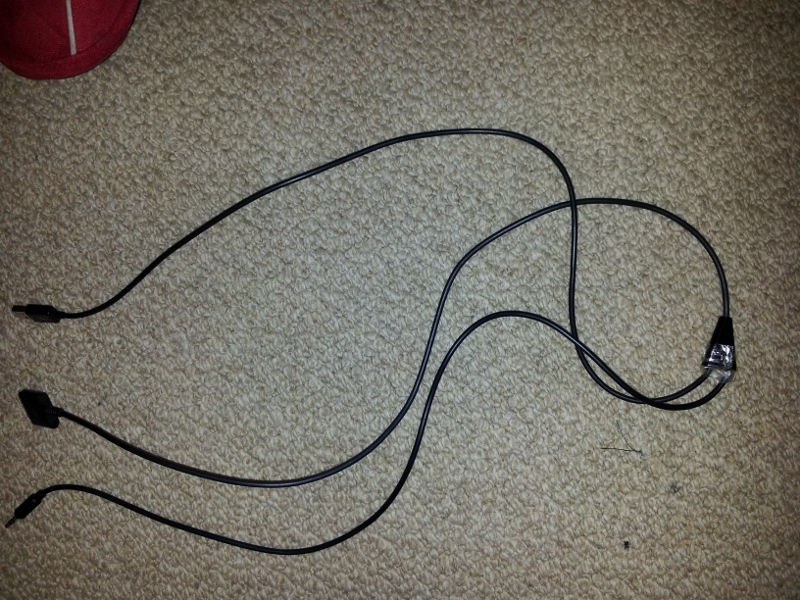

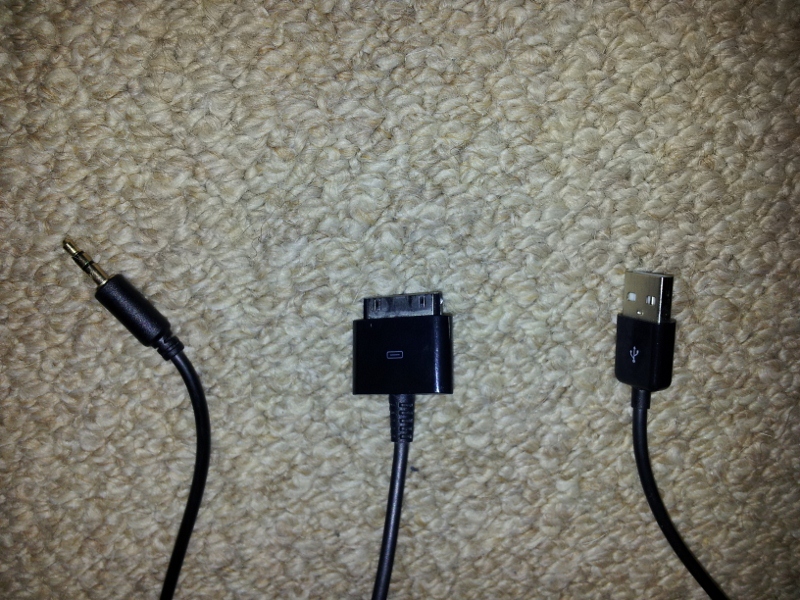

sundodger Posted February 26, 2013 Share Posted February 26, 2013 I am going to attempt the Ipod Hack tomorrow and wanted to know IF a three way would work (iphone) that way the phone charges whilst playing Please see pics plan is to strip the 3.5 jack and solder thus allowing the correct connection for the phone and the USB for the charger will this work??? just worked out how to resize pics Whey Hey!!! Quote Link to comment Share on other sites More sharing options...
Dave-350 Posted February 26, 2013 Share Posted February 26, 2013 Wouldn't think so, dont think it has the power to.. Quote Link to comment Share on other sites More sharing options...
sundodger Posted February 26, 2013 Author Share Posted February 26, 2013 How do you mean doesn't have the power too?? the USB connection will go to the cigarette lighter this is a iphone spec three way connection used it in my Astra cheers Quote Link to comment Share on other sites More sharing options...
rabbitstew Posted February 26, 2013 Share Posted February 26, 2013 (edited) Will work fine although you cant wire the usb directly to the cigar lighter as the lighter is 12v and the usb will need a 5v feed to charge the iphone. You could plug it into an adapter however. I used a cheapie cigar usb socket to convert 12v to 5v which i butchered and hid behind the dash. Edited February 26, 2013 by rabbitstew Quote Link to comment Share on other sites More sharing options...
sundodger Posted February 26, 2013 Author Share Posted February 26, 2013 Thank you Rabbitstew, I have the adapter and was going to use that. thanks again for the help Sun Quote Link to comment Share on other sites More sharing options...
WhackyWill Posted February 27, 2013 Share Posted February 27, 2013 That should work fine SunDodger, as long as you reduce down the voltage from 12v to 5v to charge your iPhone. Quote Link to comment Share on other sites More sharing options...

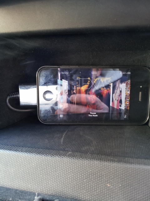

sundodger Posted February 27, 2013 Author Share Posted February 27, 2013 Brought it Jack, fitted it all today completed the Ipod hack, fed the Usb down passenger side and connected to the cig lighter and ran the iphone connection socket through the back of the cubby hold. I will post a couple of pics when i can, all works great Quote Link to comment Share on other sites More sharing options...

JackStrong Posted February 28, 2013 Share Posted February 28, 2013 Ah Brilliant. What iphone are you using ? I have an iphone 4s wired up via the apple connector but just to the head unit, not powered Quote Link to comment Share on other sites More sharing options...
sundodger Posted February 28, 2013 Author Share Posted February 28, 2013 (edited) I phone 4 Jack Edited February 28, 2013 by sundodger Quote Link to comment Share on other sites More sharing options...
