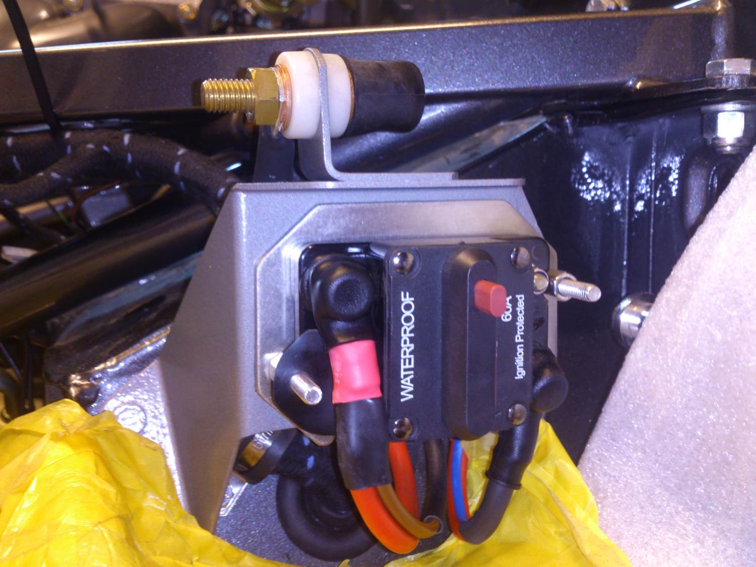

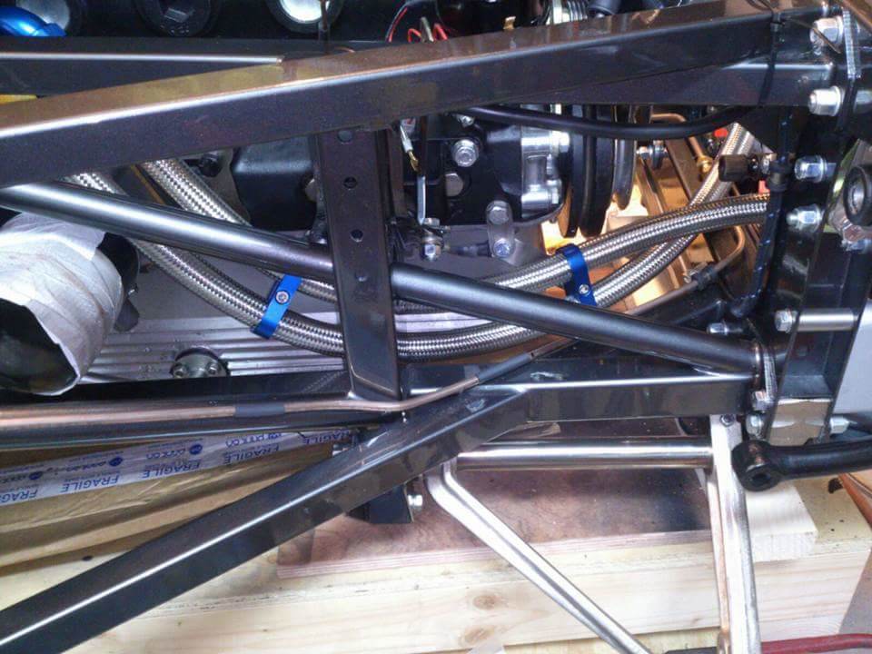

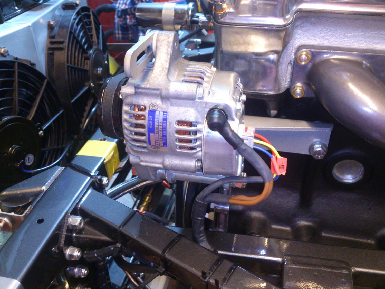

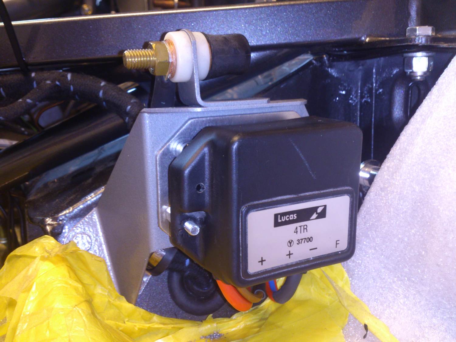

leonk Posted November 6, 2017 Author Share Posted November 6, 2017 Cheers guys. The wiring is slow going but I've found it both confusing and rewarding. Every spade or terminal crimped, soldered and heat shrieked. All the wires different colours that now mean something... all a bit more organised and logical. Anyway moving on. A few additional pics of more interesting stuff. Oil cooler plumbed in, pipes routed neatly, modern alternator and circuit breaker hidden in original housing. Quote Link to comment Share on other sites More sharing options...
leonk Posted November 6, 2017 Author Share Posted November 6, 2017 (edited) Oh and rad in with twin modern brushless fans and adjustable temp sender unit. Getting that bit closer to firing her up! Edited November 6, 2017 by leonk 1 Quote Link to comment Share on other sites More sharing options...

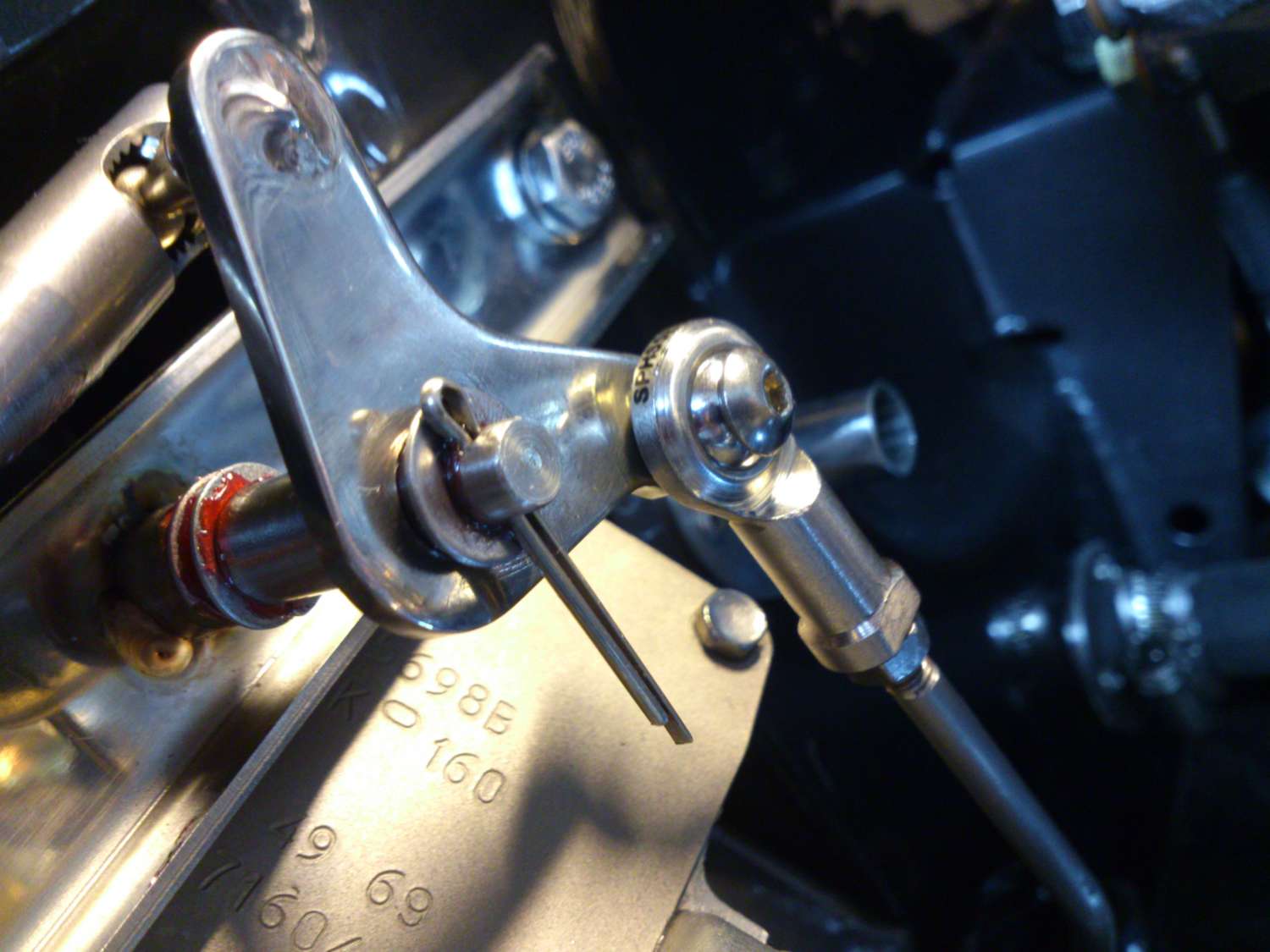

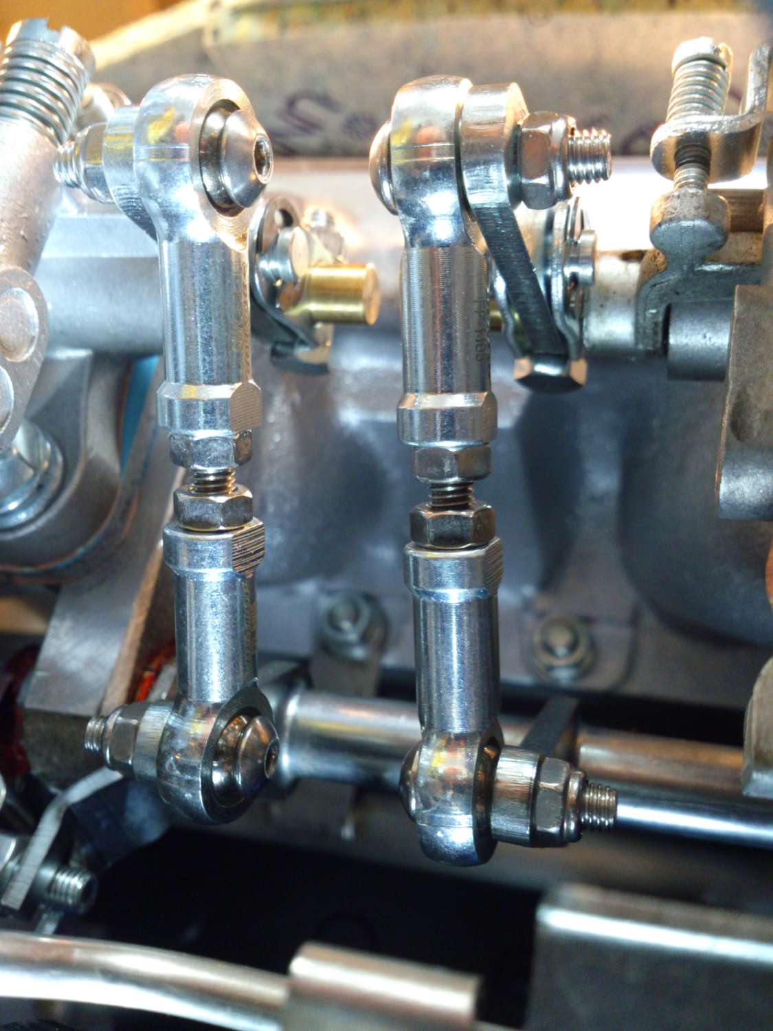

leonk Posted December 2, 2017 Author Share Posted December 2, 2017 (edited) Just for Chris . Carbs back on and all throttle linkages now rose jointed. This means I now have, fuel, oil, water, exhaust and nearly electrics. Engine cranks and oil pressure showing on new wet oil gauge. I am now tantalisingly close to firing her up but alas working this weekend. Next post will be video of her running, promise. Edited December 2, 2017 by leonk Pics 3 Quote Link to comment Share on other sites More sharing options...
