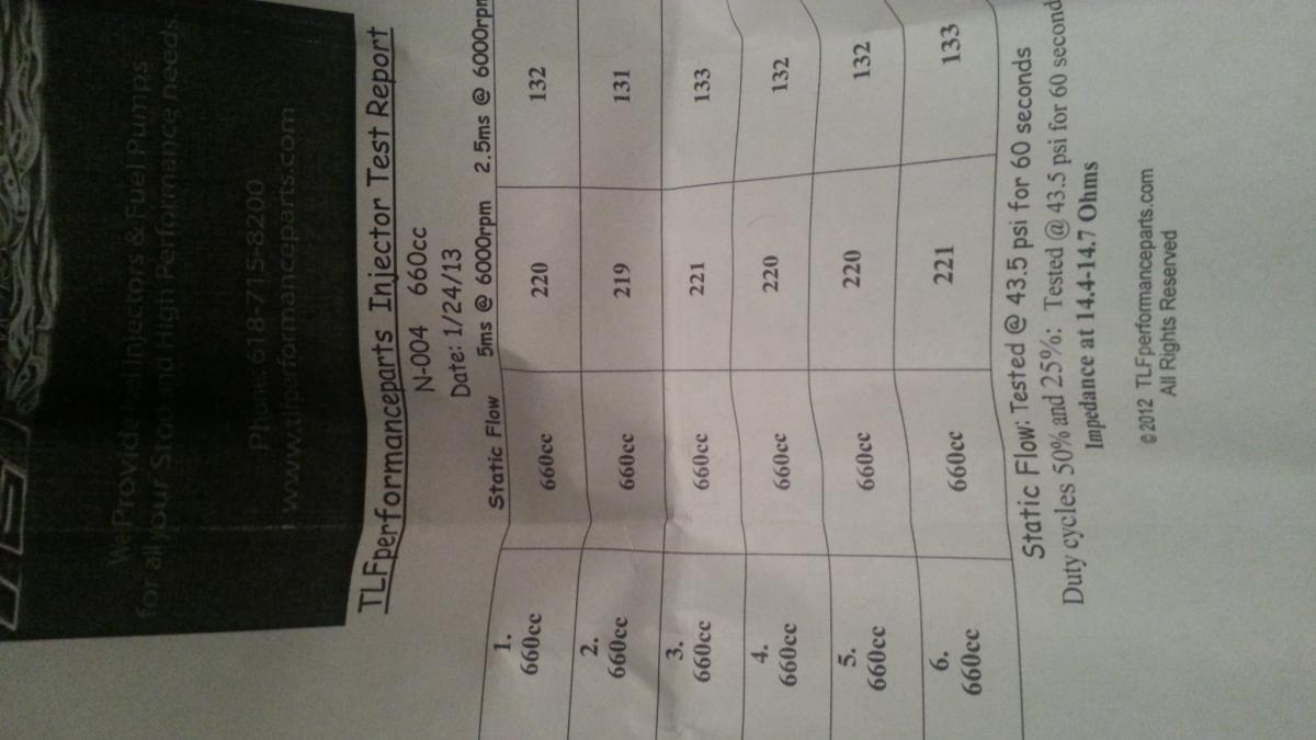

350zlew Posted February 24, 2013 Author Share Posted February 24, 2013 Whoa sorry for the overload i didnt think it was posting... hmm so do these look far off from what yours are? :-) Quote Link to comment Share on other sites More sharing options...
evilscorp Posted February 24, 2013 Share Posted February 24, 2013 Only way to tell is when your flow sheet arrives, as long as they all look similar, they should be fine, unfortunately mine only says high impedance coil type so I dont have a number to give you in comparison to your 15.1 ohms Quote Link to comment Share on other sites More sharing options...
350zlew Posted February 24, 2013 Author Share Posted February 24, 2013 Okay buddy not to worry ill check the flow sheet.... they also say high impedence but im not sure if theres different severitys of that :-) best get them tested i think :-) Quote Link to comment Share on other sites More sharing options...

GT4 Zed Posted February 24, 2013 Share Posted February 24, 2013 It's always a pleasure to have a new member and moreso when they have an interesting project to share. The injectors will be more than enough for 400whp but to tune the car properly you need the latency tables. This should be in the package if not you will need to call the manufacture to give you this. If you know the make I can get these as I have some tables from my350z for the popular injector brands. The roots type charger are very efficient down the rev range but run out if puff at the top. I will be surprise if you get up to 400whp. Quote Link to comment Share on other sites More sharing options...

350zlew Posted February 25, 2013 Author Share Posted February 25, 2013 Right the test report that came with the injectors is attached to this post... these figures dont mean much to me so i just wondered how they stack up against those who have already got uprated injectors? And would it be worth getting them tested again in the uk to be sure? Quote Link to comment Share on other sites More sharing options...
350zlew Posted February 25, 2013 Author Share Posted February 25, 2013 Sorry its come out sideways haha my bad! Quote Link to comment Share on other sites More sharing options...
