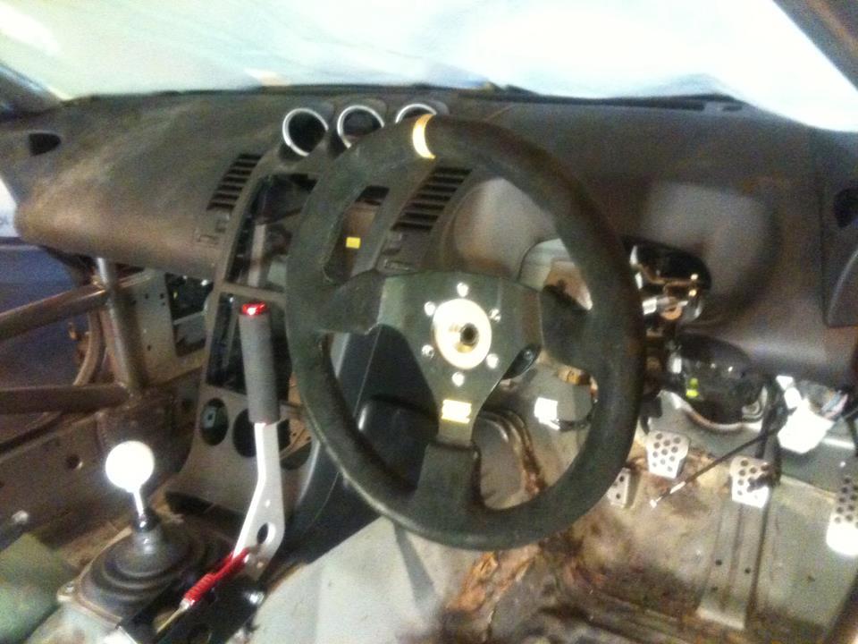

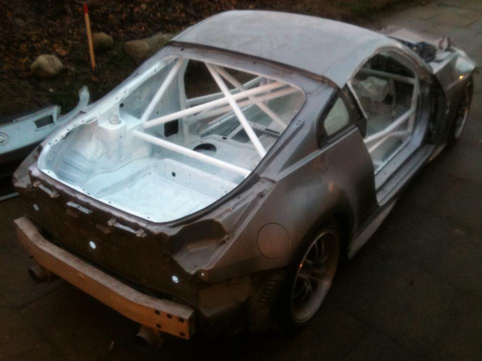

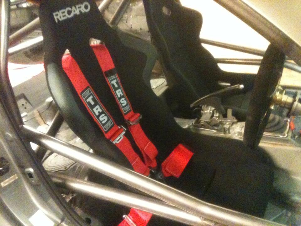

Ortega_9 Posted January 28, 2013 Share Posted January 28, 2013 Hello. I thought i woud share my supercharged 350z drifter projekt with you... this is my first 350z, but have build a heep of jap cars... mostly nissans... I´m inhere to get inspiration, tech info and input about setup etc. My car is a 2004 350z gt-pack. The chassis is right now stripped down, caged, and getting new brakeline setup, coilovers, tie rod/ends, front hubs, rear and front ajustable arms etc, new fuel setup, new electrical system, ECU and getting the vortech V3 kit fitted to the engine... still heaps to do, and I´ll start a build tread with the car... just wanted to say hi and tell you guys what I´m up to If you want to I´ll be posting progress and preporations here aswell, http://www.facebook.com/OrtegaMsport but in here I´ll keep it about the car, and build anyways, a few pictures of the work in progress Quote Link to comment Share on other sites More sharing options...

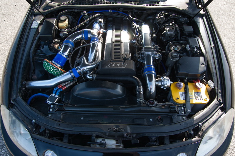

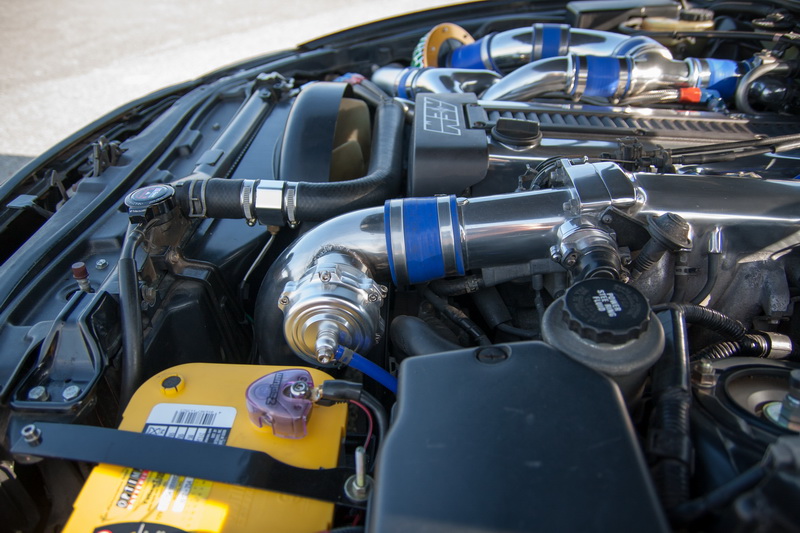

Ortega_9 Posted January 29, 2013 Author Share Posted January 29, 2013 (edited) thanks all. The FB page is a bit in Danglish i know :-) but I´ll try to post as much as possible inhere.. I can post a few pictures of post cars I´we build. Just sold my soarer and my old drifter to raise funds for this build... but here goes... And I´ll have to get some other pictures..the ones i try to upload are to big.. But here is one of my old drifter sil80 and a few of my soarer. But heres a danish site where my "old" cars are.. http://www.bilgaller...18583-_ortega__ and here is my old build threads, there is a few "imports" i sold inthere too, so not all of them were "mine".. but did alot of work on the cars to get them to Denmark and legally "MOT´d" here and sold. http://www.bilgaller...=2&userid=18583 But anyways, got the fuel rails off and picked apart yesterday. I´m gonna be running a AN 8 line from the tank to a swirlpot, and a AN 8 from that to a bosch 088 pump and from there to a Y piece, from that I ´ll run two AN6, one to each rail. and then again one AN 6 from each rail to my FPR and a AN 6 return from the FPR to the swirlpot ( and a overflow AN 6 from the swirlpot to the tank, and 660cc injektors... This might be a bit overkill, but atleast I wont be running lean.... I´ll be fitting the SC when I get the engine ready and back in the car... Hmm this might be a good time to start a build thread instead... Edited January 29, 2013 by Ortega_9 Quote Link to comment Share on other sites More sharing options...
