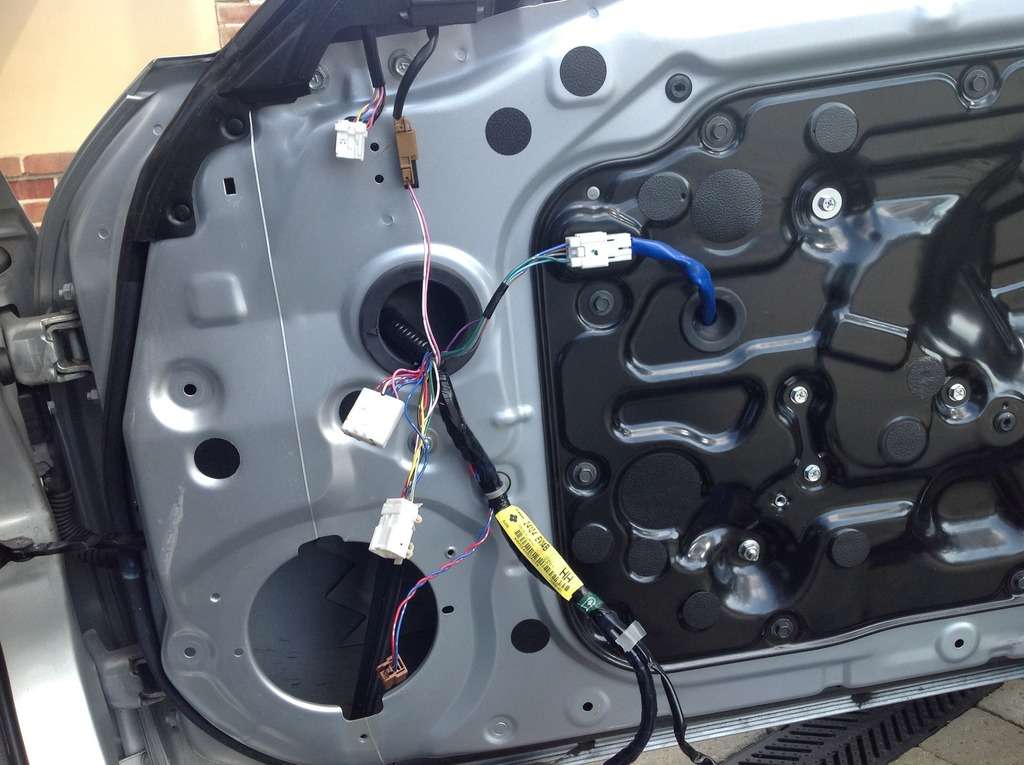

jimboy2 Posted April 6, 2015 Share Posted April 6, 2015 I can't find where the blue wires into on my HR. any help please me have the door card off and speaker out. Quote Link to comment Share on other sites More sharing options...
jimboy2 Posted April 6, 2015 Share Posted April 6, 2015 Quote Link to comment Share on other sites More sharing options...

flyboy Posted August 21, 2016 Author Share Posted August 21, 2016 Hi Guys, Im sorry but after the hard drive failure on my laptop I have lost the fitting guide and so now cant mail it out to anyone. There is a wiring schematic in the kit and it is quite easy to wire it from this. The only difficulty is finding the blue wire behind the speaker as its above the aperture once the speaker is removed and part of a bundle which are wrapped. Once you have found this then its easy peasy. I no longer have a 350Z so cant write another guide. If anyone is having difficulty then pm me with your phone number and ill try to help. 1 Quote Link to comment Share on other sites More sharing options...
