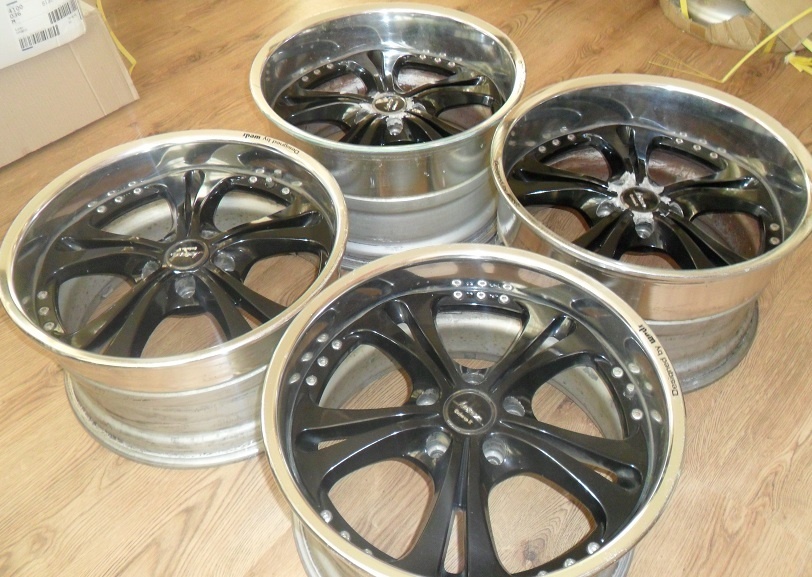

Y23DRH Posted January 20, 2013 Share Posted January 20, 2013 (edited) Just bought some Works WEDS DEEP DISH ALLOY WHEELS 18 INCH 5 X114.3 FITTMENT FRONTS=9J +25 OFFSET OVER 8cm DISH/ LIPS REARS= 10J +20 OFFSET OVER 10cm DISH/ LIPS Will i need spacers to fit these ? If so what size would i need for fronts and back i have the brembo brakes all round so need to clear them any advice would be very appreciated many thanks dan Edited January 20, 2013 by F4ABP Quote Link to comment Share on other sites More sharing options...

Y23DRH Posted January 20, 2013 Author Share Posted January 20, 2013 Yea there nice rims just need to work out what mm spacers i will need as thye dont clear the huge front brembos with out ??? Quote Link to comment Share on other sites More sharing options...
Y23DRH Posted January 20, 2013 Author Share Posted January 20, 2013 Test fitted them few days ago The rears went over the brembos bit tight but the fronts dont so need spacers just not sure on the size tho ? Quote Link to comment Share on other sites More sharing options...
S1 HNK Posted January 20, 2013 Share Posted January 20, 2013 Christ, those rears will need some serious camber! Look forward to seeing them fitted Quote Link to comment Share on other sites More sharing options...
buster Posted January 20, 2013 Share Posted January 20, 2013 think your going to need to roll the rear arch unless your running some stretch on the tyres.going to have some nice stance once your done. try a 15mm spacer on the front :wink: Quote Link to comment Share on other sites More sharing options...

roadtrip Posted January 20, 2013 Share Posted January 20, 2013 (edited) Myself and I'm sure others are running 10" rears, +20 offset with standard camber and they don't poke at all. I'm thinking that once the tyres are on, it's off the jack and resting on the ground they'll be okay, either that or the barrels have been changed and the offset isn't +20 anymore. My fronts are 9" with +20 offset and they have similar flushness to the rears, if I was you I'd tape some wood or plastic spacers (like these: Plastic Window Glass Glazing Spacers Packers) to the hub to mock-up some spacer widths to see what you need to clear the Brembos. If it takes more than 5mm then you might want to consider some small spacers on the rear to balance up the look. Edited January 20, 2013 by roadtrip Quote Link to comment Share on other sites More sharing options...
Ian Posted January 20, 2013 Share Posted January 20, 2013 Myself and I'm sure others are running 10" rears, +20 offset with standard camber and they don't poke at all. I'm thinking that once the tyres are on, it's off the jack and resting on the ground they'll be okay, either that or the barrels have been changed and the offset isn't +20 anymore. My fronts are 9" with +20 offset and they have similar flushness to the rears, if I was you I'd tape some wood or plastic spacers (like these: Plastic Window Glass Glazing Spacers Packers) to the hub to mock-up some spacer widths to see what you need to clear the Brembos. If it takes more than 5mm then you might want to consider some small spacers on the rear to balance up the look. +1 I had 10.5" rears and they didn't stick out. I'd go for 10mm spacers, which coincidentally I have for sale at the moment Quote Link to comment Share on other sites More sharing options...
Y23DRH Posted January 20, 2013 Author Share Posted January 20, 2013 hmm thanks every one will see if i can mock up some spacers and go from there if its to much hassle i will leave the rays on the car as they do suit it quite well Quote Link to comment Share on other sites More sharing options...
