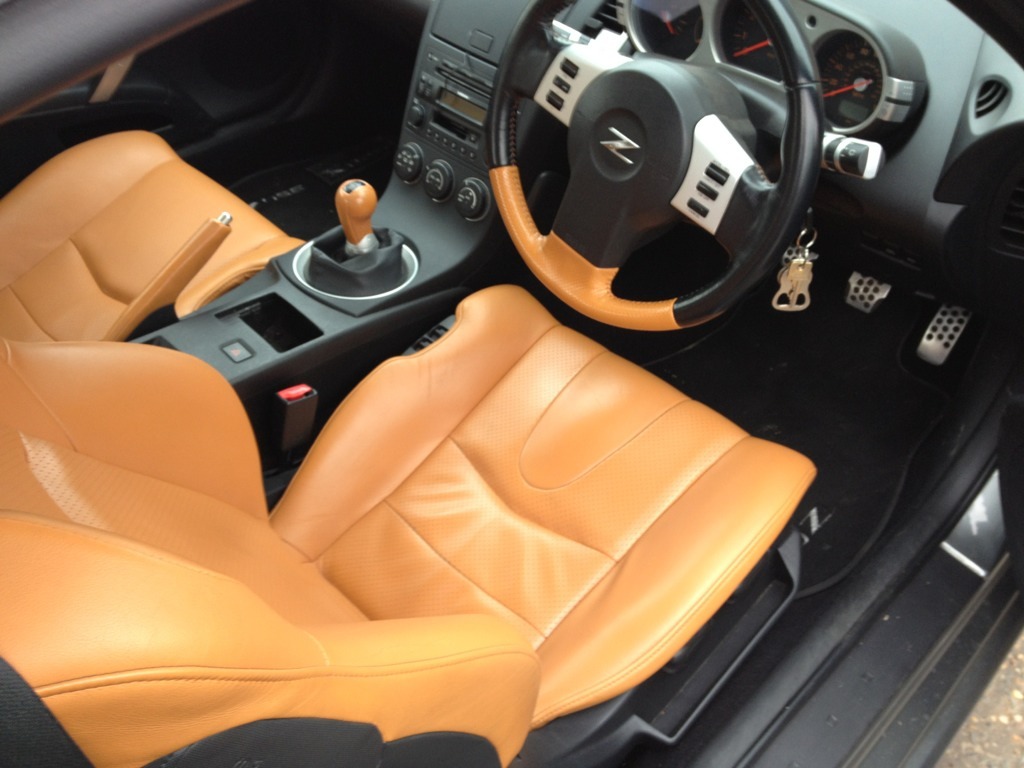

Mooresy14 Posted January 19, 2013 Author Share Posted January 19, 2013 Dave do you know where there is a diagram and guide to take off the font panel bit and show what tools I need as I dont want to scratch it, cheers pal. Quote Link to comment Share on other sites More sharing options...
spursmaddave Posted January 19, 2013 Share Posted January 19, 2013 What year Zed do you have? Does it have a silver trim around the gear knob? Quote Link to comment Share on other sites More sharing options...
Mooresy14 Posted January 19, 2013 Author Share Posted January 19, 2013 erm, 54. yes i think so. you mean the circle underneath the leather? then yes Quote Link to comment Share on other sites More sharing options...
Mooresy14 Posted January 19, 2013 Author Share Posted January 19, 2013 Quote Link to comment Share on other sites More sharing options...
spursmaddave Posted January 19, 2013 Share Posted January 19, 2013 Ok, the gear surround just pulls up, put your hands through the gaiter annd pull up. All depends how they fitted the HU though, they could have fitted the cage to the car (easy) or to the actual fascia (more difficult) Quote Link to comment Share on other sites More sharing options...
