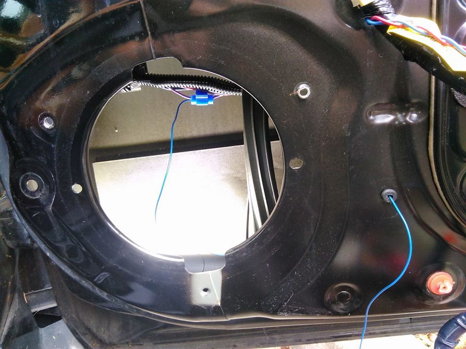

Erni902 Posted July 15, 2017 Share Posted July 15, 2017 Anyone have a picture of the purple wire to splice into behind the speaker? I removed the speaker but have a couple lots of wiring harnesses but they are all insulated so don't want to cut through all the wiring harnesses to find the right one especially seen as its susceptible to water ingress. Thanks in advance Quote Link to comment Share on other sites More sharing options...
MDMetal Posted July 16, 2017 Share Posted July 16, 2017 (edited) On 15/07/2017 at 14:54, Erni902 said: Anyone have a picture of the purple wire to splice into behind the speaker? I removed the speaker but have a couple lots of wiring harnesses but they are all insulated so don't want to cut through all the wiring harnesses to find the right one especially seen as its susceptible to water ingress. Thanks in advance Expand when people say behind the speaker what do they mean? There's no wires begin my speaker! (it is the big speaker right?) wired mine up but it refuses to open or close the mirrors automatically so guess over wired the purple wire wrong, also my open close switch is now reversed, doing well! Edited July 16, 2017 by MDMetal Quote Link to comment Share on other sites More sharing options...
taybo Posted July 16, 2017 Share Posted July 16, 2017 On 16/07/2017 at 18:30, MDMetal said: when people say behind the speaker what do they mean? There's no wires begin my speaker! (it is the big speaker right?) wired mine up but it refuses to open or close the mirrors automatically so guess over wired the purple wire wrong, also my open close switch is now reversed, doing well! Expand I'm in the same boat as you MD! This is the purple wire I spliced to to begin with. Then found out this is wrong. There is a split conduit loom wire behind the speaker in my Revup and I have found the purple wire in that lot to splice into but mine is still doing the same as yours. Still haven't had time for a 3rd attempt atm. Here is where I splice behind the speaker. Quote Link to comment Share on other sites More sharing options...
