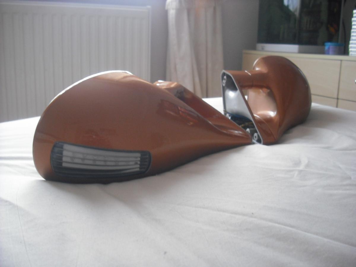

My girlfriend bought me a set of chrome 350z wing mirrors with built in led indicators for x mass,and lets just say I was not the biggest fan of them.Now I have resprayed them I think they look good on the zed,fitment is good and was planning to keep them.Only problem is how to wire them up?When it comes to electrics I have no idea so any help/advise would be appreciated on how to do it.Thanks Richard
I am guessing you will need to wire them in to your side indicators. So fix to door, run wires down to front wings, and then you can splice in to the existing ones for the side indicators.
You will most likely have to remove the arch liners/wheel to get decent access. Also be very careful removing the side indicators, as the clips can break quite easily.

Thanks for the quick reply mate!!Will give it a go once the weather picks up.Have a good new year.
