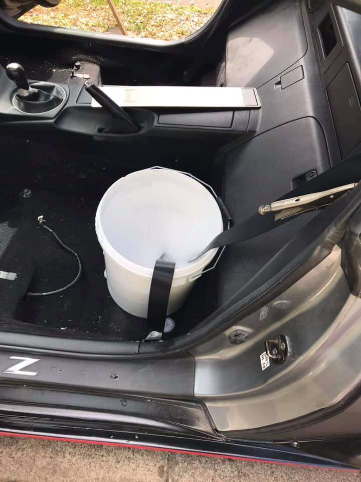

evilscorp Posted September 25, 2019 Author Share Posted September 25, 2019 Washer pump replacement was easy.... except I underestimated the amount of fluid it held. 6L + spillages I recon. Cheers Alex, My getto boost leak equipment was a fail. The throttle body butterfly doesn't seal so the air was going straight out the exhaust I suspect but I did find a leak from the cosworth manifold, so I will need to use silicone gasket as the o ring is not sealing at the front top section right where a bolt is, tried to nip it up but no change. Ordered a 3" plastic pipe end cap and I will cap off just before the 3" maf pipe as there isnt room to do it at the throttle body coupler. 1 Quote Link to comment Share on other sites More sharing options...

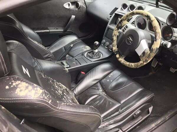

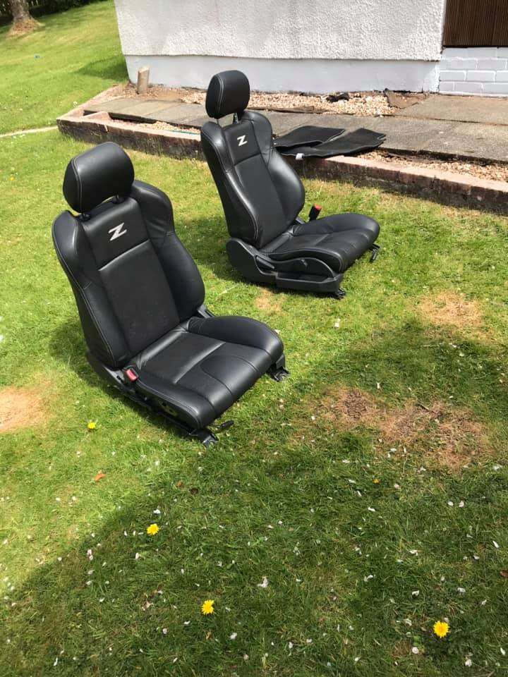

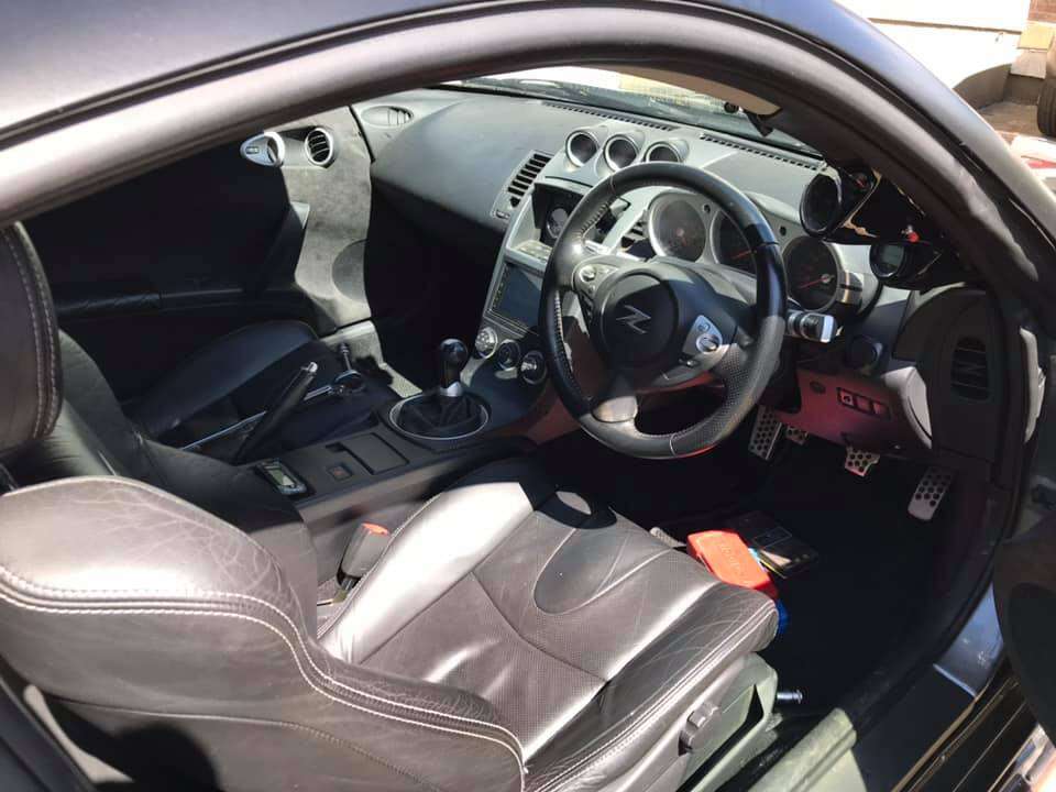

evilscorp Posted May 27, 2020 Author Share Posted May 27, 2020 changed my steering wheel for a 370z one, as you can see it didn't like the cold/damp winter under the car cover then the really hot weather at the start of the month. Had to rip everything out for a clean. Might redo the headliner now I know how to remove it. Quote Link to comment Share on other sites More sharing options...
evilscorp Posted May 27, 2020 Author Share Posted May 27, 2020 Also I can now wire my stereo for hand controls which will be cool. air bags were plug and play, panic set in when american youtube video showed different connections. Quote Link to comment Share on other sites More sharing options...

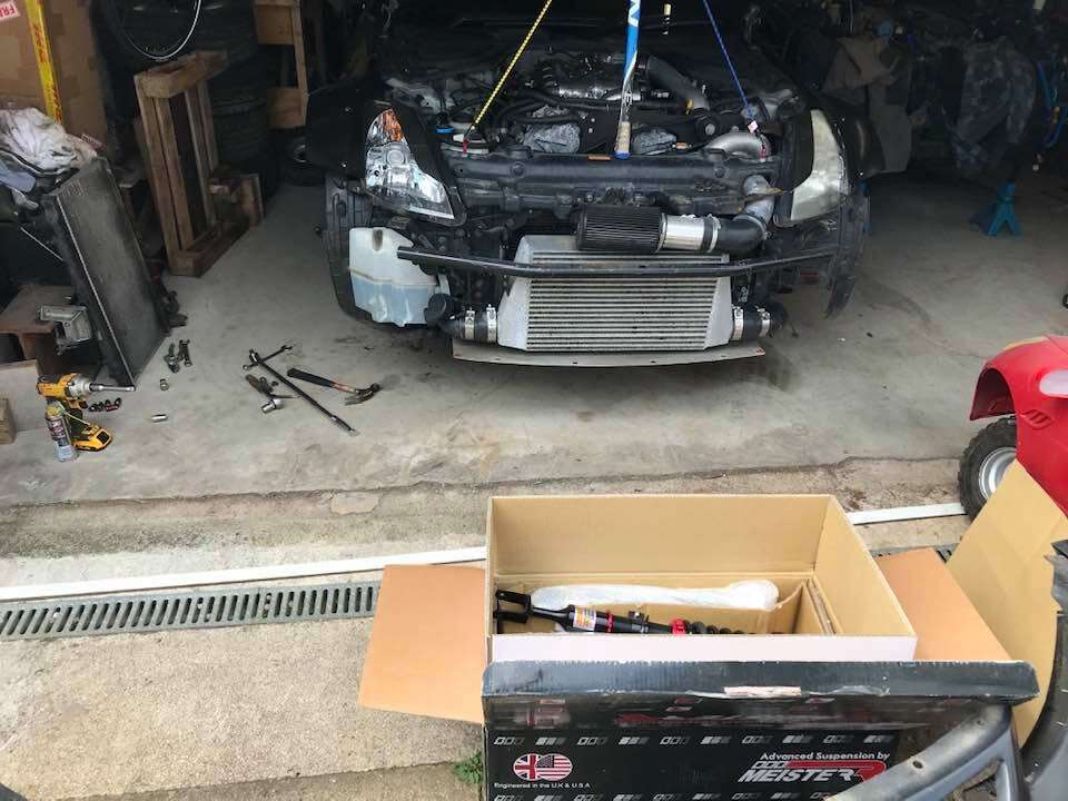

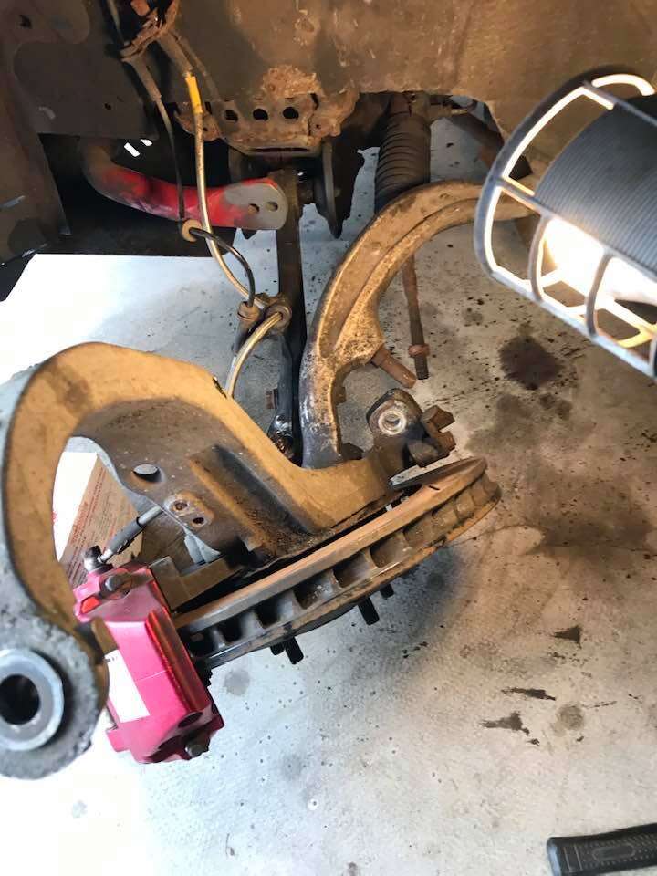

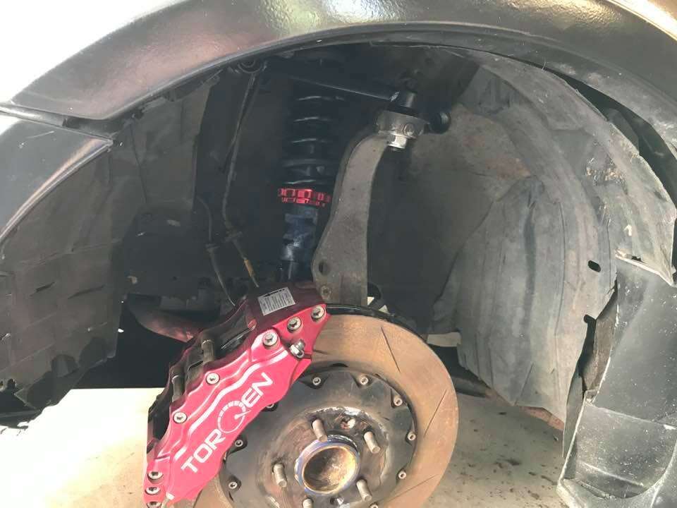

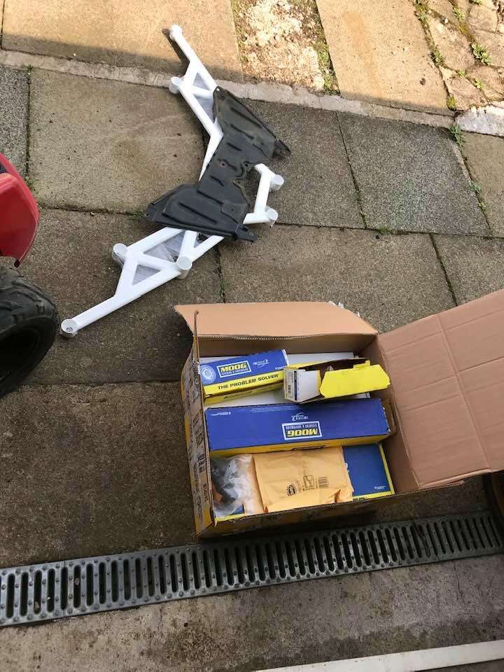

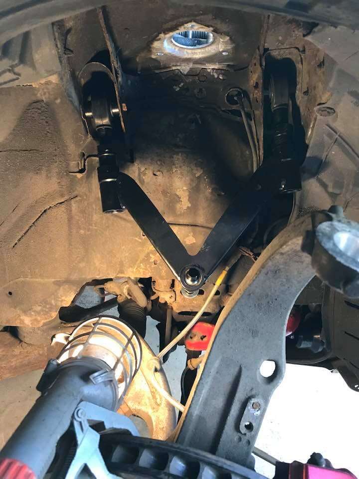

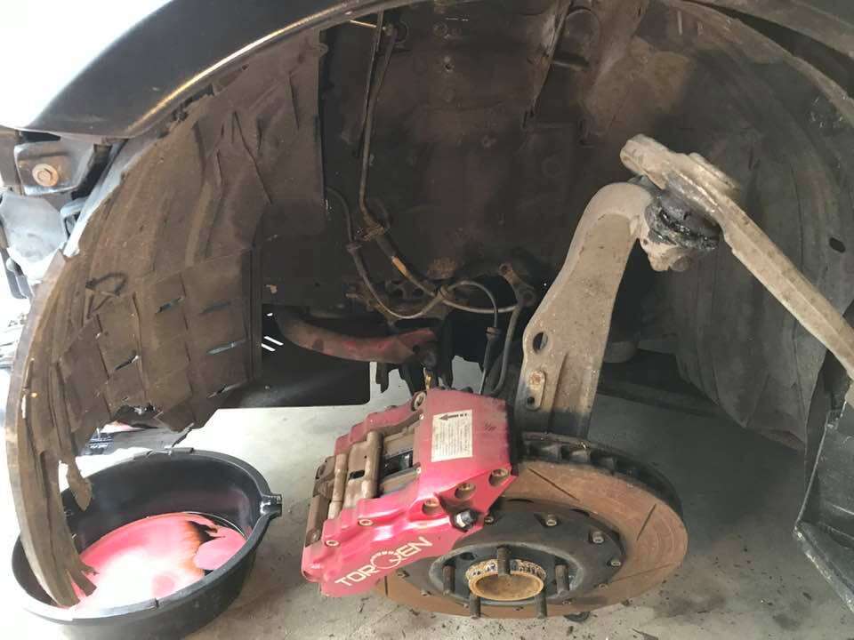

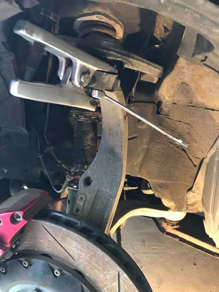

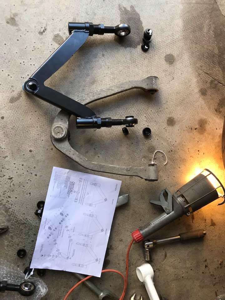

evilscorp Posted August 17, 2020 Author Share Posted August 17, 2020 Front end suspension overhaul as the whiteline drop links came up as and advisory last mot and I knew the bushes were shot on everything as all the arms were OEM 2003 parts. Also did an oil change on supercharger and main oil 5w-40 castrol edge. Front brace is rot so swapping that out too. Had to cut off upper camber arm nut as it wouldnt budge and I cheaped out and only bought tie rod ends and the jam nuts are welded on with rust so having to wait for new inners. GKtech new designed upper camber arms will be easy to adjust on the car due to the design, just footery to hold the 8spacers (castor adjustment) while trying to bang the arm in place (one side was very tight to get into location). But if it allows me to adjust (or get someone with a hunter alignment system if I can't be bothered) without having to take the wheel off each time then brilliant. 3 Quote Link to comment Share on other sites More sharing options...
