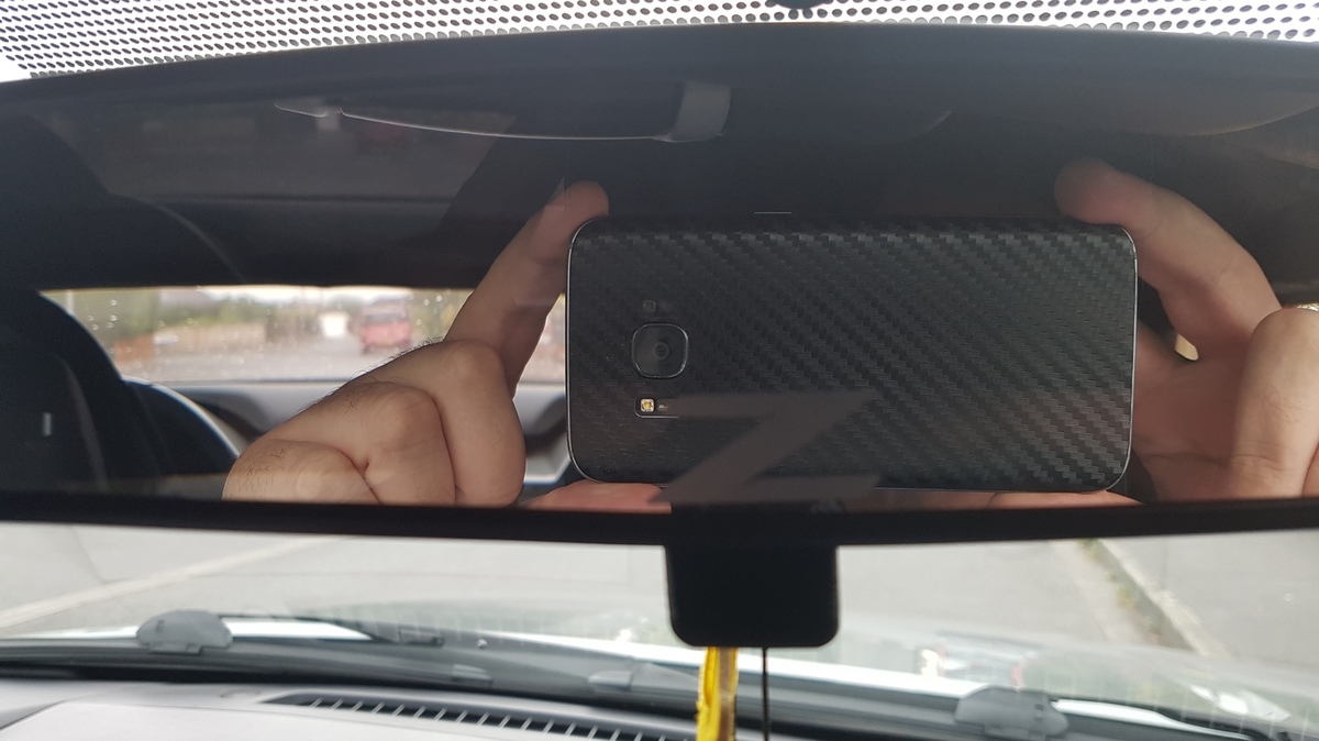

Willsy1980 Posted August 21, 2017 Share Posted August 21, 2017 Well, not today but yesterday added some mirror mods... 2 Quote Link to comment Share on other sites More sharing options...
Erni902 Posted August 25, 2017 Share Posted August 25, 2017 On 8/21/2017 at 17:16, Willsy1980 said: Well, not today but yesterday added some mirror mods... Haha I did this exact mod a couple months ago and even have the same angry birds air freshener lmao Looks good mate 1 Quote Link to comment Share on other sites More sharing options...

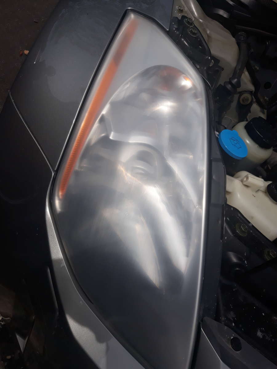

Willsy1980 Posted June 24, 2018 Share Posted June 24, 2018 Not exactly a mod, but an improvement... Yellowed headlights, wet sanded with 600>800>1000>1500 and clearcoated Before, during and after. 2 Quote Link to comment Share on other sites More sharing options...
