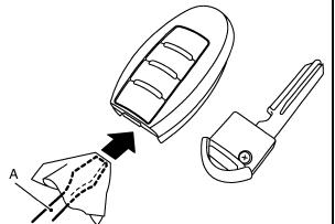

Harryjax Posted December 10, 2012 Share Posted December 10, 2012 Component Inspection INFOID:0000000001683135 REPLACE INTELLIGENT KEY BATTERY 1. Release the lock knob at the back of the Intelligent Key and remove the mechanical key. 2. Insert a flat-blade screwdriver (A) wrapped with a cloth into the slit of the corner and twist it to separate the upper part from the lower part. CAUTION: • Do not touch the circuit board or battery terminal. • The key fob is water-resistant. However, if it does get wet, immediately wipe it dry. 3. Replace the battery with new one. 4. Align the tips of the upper and lower parts, and then push them together until it is securely closed. CAUTION: • When replacing battery, keep dirt, grease, and other foreign materials off the electrode contact area. • After replacing the battery, check that all Intelligent Key functions work normally. Sorry i tried to attach pictures but i couldn't do it for some reason! if you PM me your e-mail address i will send you a detailed Pdf file from the the worshop manual. 1 Quote Link to comment Share on other sites More sharing options...
