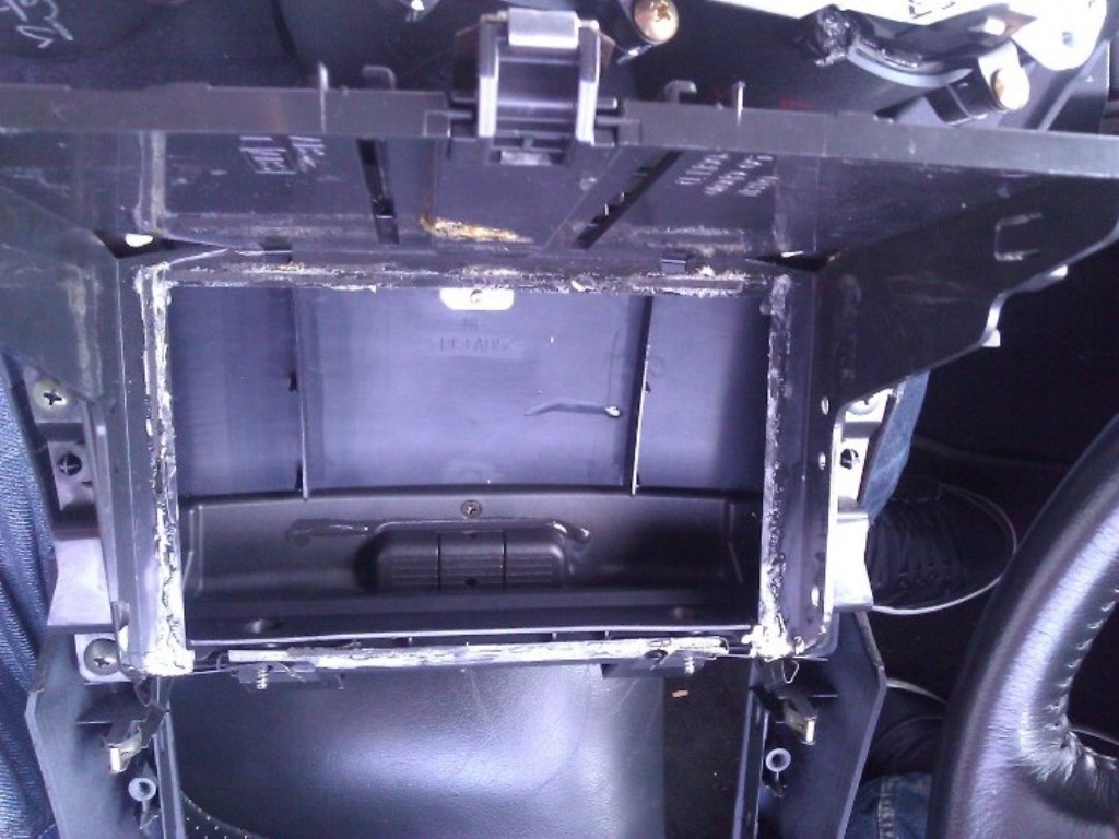

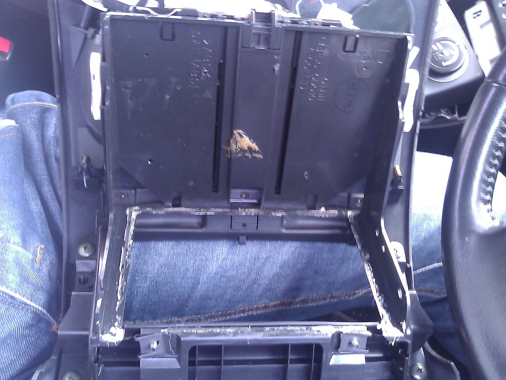

spursmaddave Posted July 12, 2012 Share Posted July 12, 2012 Ok I found my old cubby and compared it to the satnav cubby.... I think a 7" screen of some sort would fit, but you would have to butcher the cubby up so much and you would also loose the lid so personally I would get a satnav one You would have to cut all the back off from the inset bit... Which is where the lid is attached to Your only real option with the standard cubby is to fit a smaller nav or tablet inside it, a 5" one maybe... Quote Link to comment Share on other sites More sharing options...
ashyk36 Posted July 12, 2012 Share Posted July 12, 2012 So after opening my dash to take the measurements but i still cant see how it can be done without taking the tablet apart apart. I have the cubby with the retractable lid if that helps Any help would be appreciated Quote Link to comment Share on other sites More sharing options...

ashyk36 Posted July 12, 2012 Share Posted July 12, 2012 This is another picture I took earlier on, this is the satnav 1, the lid goes all the way inside the compartment As you can see in the picture the space between the mechanism and and the start of the hole is roughly about 50mm Quote Link to comment Share on other sites More sharing options...
