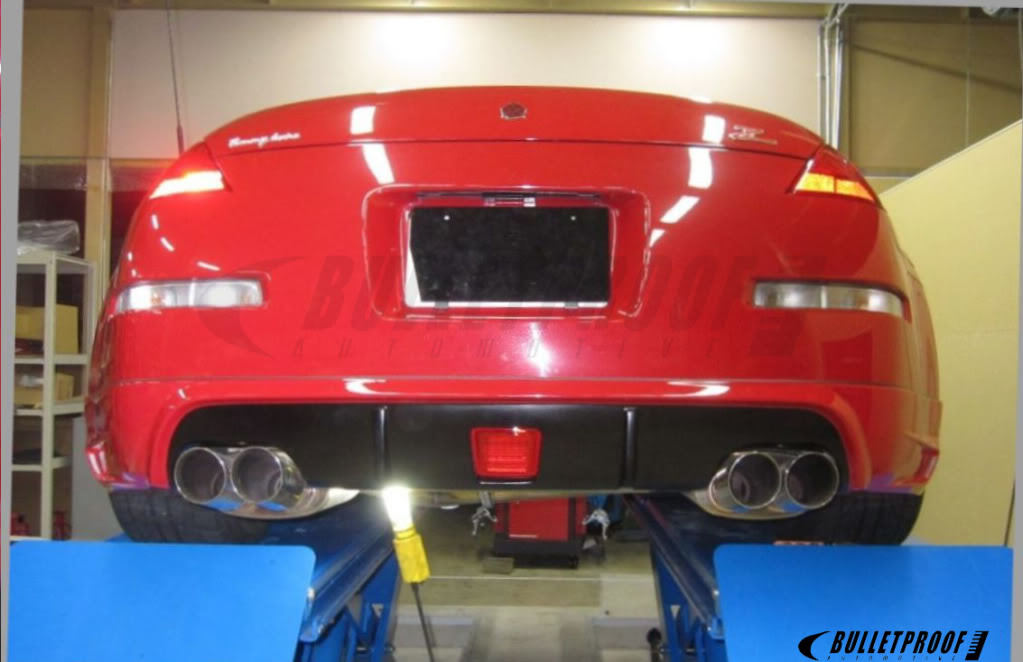

jumping350 Posted May 20, 2012 Share Posted May 20, 2012 (edited) This might be a marmite moment for some people but i like the idea so will see how it goes. Recently my JDM fog has died never worked great in first place any how i dont want a unnatural stuck on jobby for a foggy and i love the rear end of the 370z so got thinking could i incoroporate the two?? has it been done before?? the closest i could come to was a tommy kaira rear half except you would need tommy kaira exhaust i think aswell for it too work i currently dont have $6000 so that idea went out the window but looks ok Edited June 8, 2013 by jumping350 Quote Link to comment Share on other sites More sharing options...
jumping350 Posted May 20, 2012 Author Share Posted May 20, 2012 Any how after bit of measuring etc from a friends 370z and seeing how keyser has done his rear bumper the cogs in my mind started turning so i went and searched for 370z that were being broken (theres in literally 2 i found) so got these 2 items the inside top of rear bumper has been massacred luckily dont have to use it! option 1 is cut diffuser out and bond to bumper option 2 cut rear half of bumper (like tommy kaira) and bond and smooth to rear bottom half like keyser done Main thing is diffuser exhaust holes are identical to the 350s so will work some how just got to figure it out Getting a second bumper to do this on so can see how it turns out first Quote Link to comment Share on other sites More sharing options...
