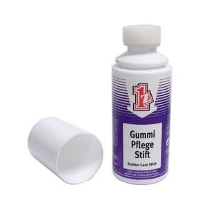

spursmaddave Posted April 25, 2012 Share Posted April 25, 2012 You aren't teasing me are you with Vaseline and baby oil? If it's true, I will go and buy some and try it but I know how you all like to pull my leg Not at all, the any type of lube will do I treat my seals with gummipfledge Quote Link to comment Share on other sites More sharing options...

ChrisS Posted April 25, 2012 Share Posted April 25, 2012 You aren't teasing me are you with Vaseline and baby oil? If it's true, I will go and buy some and try it but I know how you all like to pull my leg Not at all, the any type of lube will do I treat my seals with gummipfledge +1 ^^^^^^ that's the same stuff I use. Better for a car used by a lady, as no oil,WD40 etc. to get out of clothes if they happen to touch the rubber. (two women in our house,that's why I use gummmyyyyy) Edit. The window can also be adjusted,it's in the guides somewhere. Quote Link to comment Share on other sites More sharing options...

twobears Posted April 28, 2012 Author Share Posted April 28, 2012 Oi, you filthy minded lot I wanted the Gummi Pfledge stuff (apologies if I've misspelt that one) but I couldn't find it anywhere so I have bought some baby oil instead. It's not actually raining now - shock horror - so I will go out and paint a bit on the seals and see what happens in the next downpour. Don't suppose I'll have to wait long Quote Link to comment Share on other sites More sharing options...
NeilMH Posted April 28, 2012 Share Posted April 28, 2012 You can get the gummi stuff on ebay. Quote Link to comment Share on other sites More sharing options...

ilogikal1 Posted April 28, 2012 Share Posted April 28, 2012 I hate eBay I do sometimes have to resort to using it though. And sometimes you don't. Clicky. Quote Link to comment Share on other sites More sharing options...
