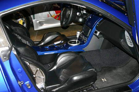

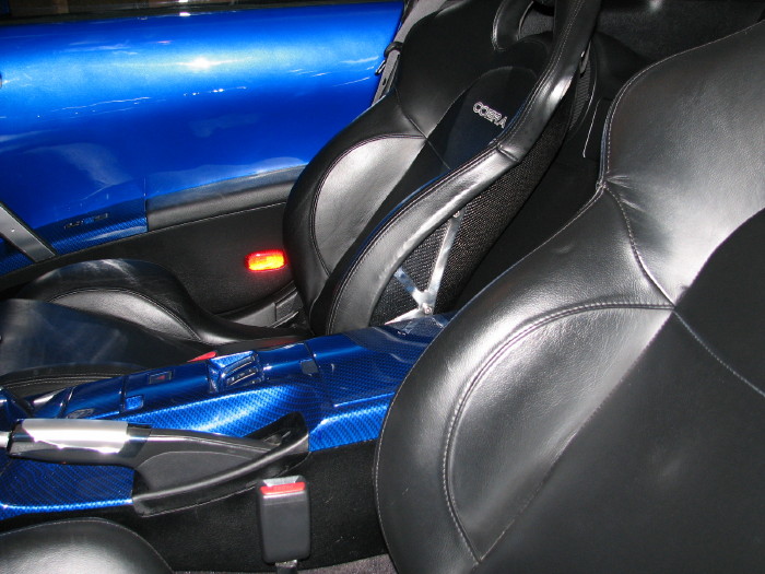

Im alive .....(just been dead busy with work etc .. )
Yep I swopped my seats out, the ones I picked were Recaros out of a Civic of all things.
All you need then is some subframes, I used Bride subframes imported from Japan, they needed a little alteration but I got them in in the end,
recaro also do make them but being recaro they cost muchos dollar....
All you need to do then is to get rid of your airbag warning light , this bit is easy, as all you need is a 2.2 ohm resistor from maplins .
Pics attached ..
Steve
