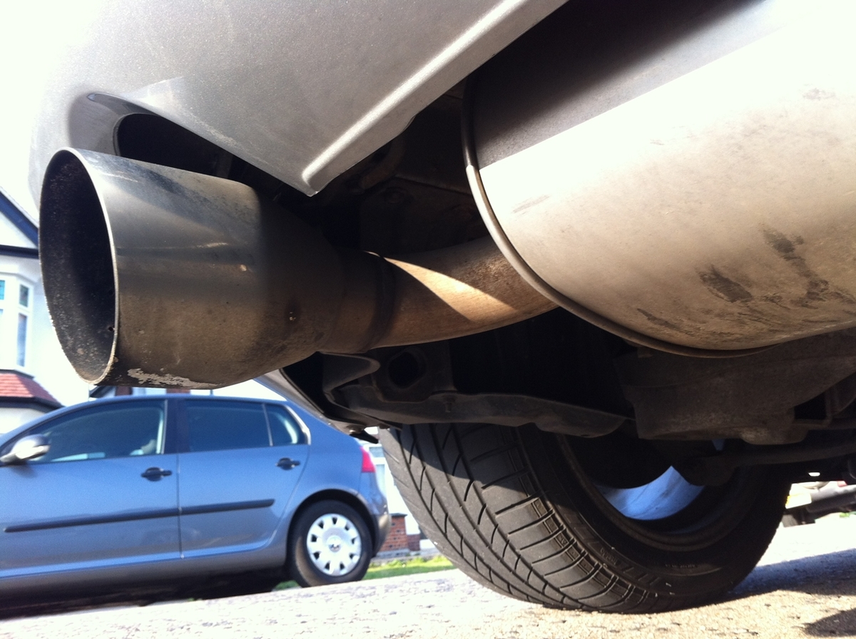

silversurfer Posted March 5, 2012 Share Posted March 5, 2012 Hey All As I mentioned in another forum here on 350z, I just purchased a UK 04 350z GT yesterday and want to get it cleaned up and running like it should do. Although equipped with a Bose stereo (which I've experianced in previous cars) there's no evidence of any typical Bose bass. Any ideas? The airbag light is flashing. What's the fix as I read this was a common problem? The last service was carried out 3 months ago at Kwick Fit with just FULL SERVICE written in the service wallet. Although all previous stamps in the book point at a good FSH I'd like to get the oils changed for some peace of mind. What's the best spec of oil (and on-line supplier if possible) for the diff, gearbox and engine? It's got an aftermarket exhaust fitted. I'm not sure the make of it, but getting down on my hands and knees I noticed the tips can be changed (although welded), and they're the bits I have the issue with as I prefer the more subtle diameter of the stock tips. Can the tips be changed by themselves? Where do you recommend purchasing some good quality subtle tips from? Is there any recommendation for a good local independent specialist garage in the IG1 area? Thanks in advance for your answers / tips and suggestions. Quote Link to comment Share on other sites More sharing options...

DoogyRev Posted March 5, 2012 Share Posted March 5, 2012 The bose is an easy fix...... get a new Head Unit and speakers Airbag light ..... try moving the seat forward and checking the connections Kwik Fit ... I would go to a decent establishment for a service... PM or Oilman for servicing parts Post up some pics of your exhaust and I am sure someone will tell you what it is Quote Link to comment Share on other sites More sharing options...
silversurfer Posted March 5, 2012 Author Share Posted March 5, 2012 The bose is an easy fix...... get a new Head Unit and speakers Airbag light ..... try moving the seat forward and checking the connections Kwik Fit ... I would go to a decent establishment for a service... PM or Oilman for servicing parts Post up some pics of your exhaust and I am sure someone will tell you what it is Thanks DoogyRev There must be an alternative to replacing all the ICE just to get the sub working - there must be I'll post a couple of pics of the pipe, but they will be reliant on the flash as I'll only be able to take them on returning from work tomorrow. I'll wait till the weekend before having a look behind the seat as it needs a thorough clean anyway. Quote Link to comment Share on other sites More sharing options...

silversurfer Posted March 11, 2012 Author Share Posted March 11, 2012 [/album] no worries mate, like i said these worked for me, good luck It all worked The Bose sounds more Bose like, and the airbag light is a memory - I can't believe the previous owner didn't bother finding out how to deal with these irratations . What I need to do next is: Get the engine, gearbox and diff oils changed Get the tips of the exhaust changed back to the stock ones. For the fluid changes I need a decent specialist independent garage somewhere near IG1 (Ilford) so any assistance would be appreciated by means of a recommendation. For the exhaust tips I was asked for some pics: Thanks in advance Quote Link to comment Share on other sites More sharing options...
drysd4le Posted March 12, 2012 Share Posted March 12, 2012 glad it all worked I cant help with the exhaust but I will say I changed mine also as I had similar tips to yours, got them changed out for nice stainless slight oval rolled tip ones, look miles better imo. Quote Link to comment Share on other sites More sharing options...

KyleR Posted August 28, 2012 Share Posted August 28, 2012 Exhaust looks a Scorpion. It's a good budget box and I would personally keep it if I purchased the car with it, although, like you, i'd chop the tips off and get better looking ones welded on. Any decent exhaust place should be able to do that for you. Quote Link to comment Share on other sites More sharing options...
