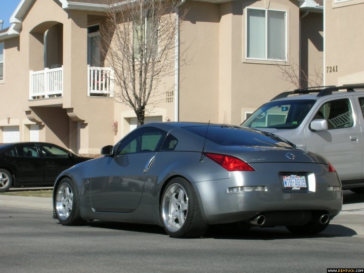

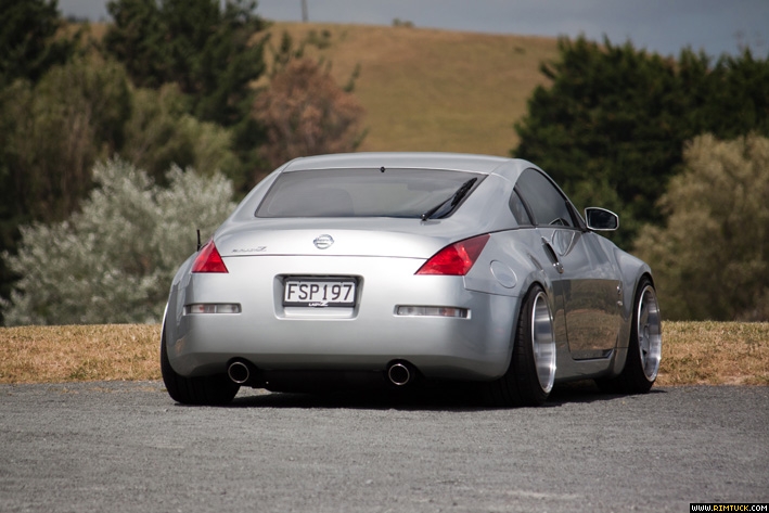

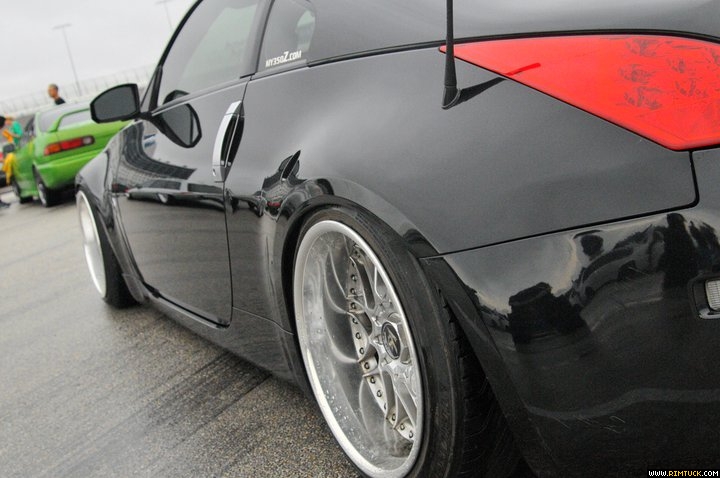

agentsmith350 Posted February 29, 2012 Author Share Posted February 29, 2012 Using the online calc says id have 16mm less clearence inside so would need 20mm spacers or something pushing the wheel out even more and had a read up on my350z , apparently no chance without pulling fenders , FFS back to the hunt Although it would look all kind off awsome : Quote Link to comment Share on other sites More sharing options...
docwra Posted February 29, 2012 Share Posted February 29, 2012 Would a roll actually make 12's fit or still need pulled ? Using the online calc says id have 16mm less clearence inside so would need 20mm spacers or something pushing the wheel out even more You are assuming you dont have 16mm of clearance already there though, you probably do. No man can 100% categorically say what will fit and what wont, I can give you advice based on personal experience but things like tyre wall profile, suspension camber, degree of loweredness (new word, woo!) can all make a difference. Examples though: 18x12 ET0 with 275/35 tyre, running 3.25 degs camber: 18x11 ET 0 with 245/40 tyre, standard camber: 18x10 ET -13 with a 275/35, standard camber and arches almost certainly only rolled: Back on the first page youve got mine as well, 10J ET15 with 255/35 tyre IIRC, standard camber, no archwork at all. Quote Link to comment Share on other sites More sharing options...
