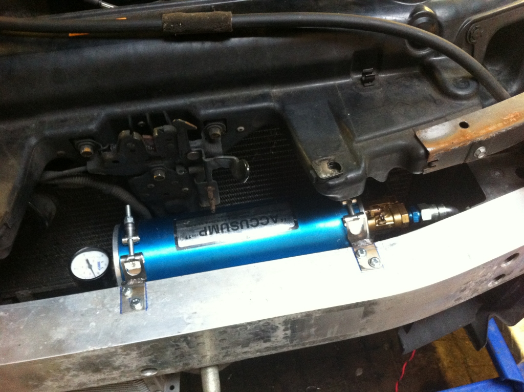

Jez @ H-Dev Posted July 12, 2012 Author Share Posted July 12, 2012 Haven't had a chance to do a great deal to the car recently. We have fitted an accusump to the oil system - this will help reduce the chance of oil surge when running slicks on track. Took the car out at Blyton Park last weekend - as usual the car ran without any problems and was great fun. Docwra was there too, although our paths didn't cross on track. Going to Rockingham on the 12th August, with a 430bhp S13 and a ~600bhp RX7, if anyone is interested Quote Link to comment Share on other sites More sharing options...
