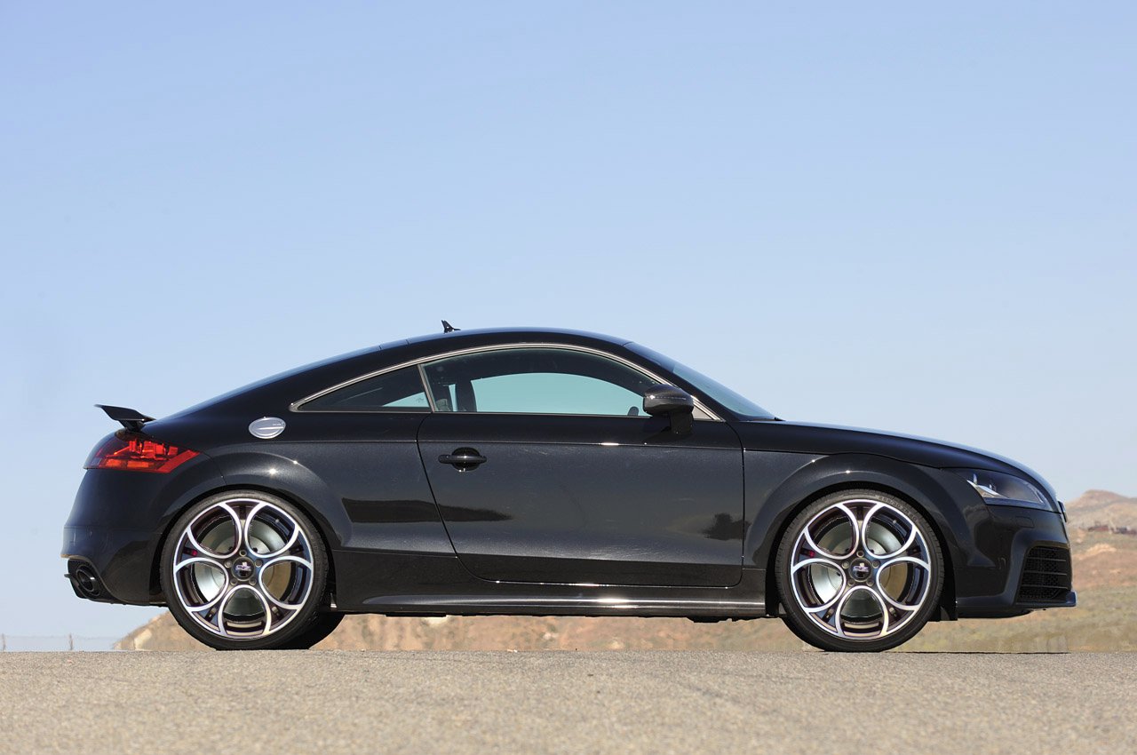

sasha@lazytrips Posted November 29, 2011 Author Share Posted November 29, 2011 Here's the wife's choice (she's a fan of those Brera rounded wheels too): O.Z. Racing Wave. I've heard some good things about O.Z. Racing in general. Am I right in thinking that they're a decent brand? Here's the wheel: Anyone know anywhere where I can get this wheel at a good price? All internet prices seem to be identical. Quote Link to comment Share on other sites More sharing options...

SteveM Posted December 8, 2011 Share Posted December 8, 2011 I am not 100% sure, but I think the bore is 57.1 and there are 5x 112 studs - if someone knows a way to confirm this, I would be delighted. Phoned 2 Audi garages and they can't tell me! all the info i can find tells me that..... Audi TT 99 > 06 5x100 PCD 20 to 25 offset with a bore of 57.1 tyre sizes for alloys should be 17" 225x45x17 18" 225x40x18 19" 235x35x19 20" 225x35x20 Audi TT 06> 5x112 PCD 42 to 50 offset with a bore of 57.1 tyre sizes for alloys should be 17" 225x50x17 18" 245x40x18 19" 245x35x19 20" 245x30x20 hope that helps for me i dont think the TT would suit the rounded opening style of those wheels but i guess its personal taste for me i like the R8 style especially on something like the TT Quote Link to comment Share on other sites More sharing options...

sasha@lazytrips Posted December 10, 2011 Author Share Posted December 10, 2011 Thanks for all the replies! Had a further think and a look around and the original choice appears to work quite well. I exercised my poor photoshopping skills and the TT seems to look quite nice with those OZ Wave wheels (excuse the lack of callipers - was just way too lazy IMO definitely they look nicer than I originally thought they would. Quote Link to comment Share on other sites More sharing options...
