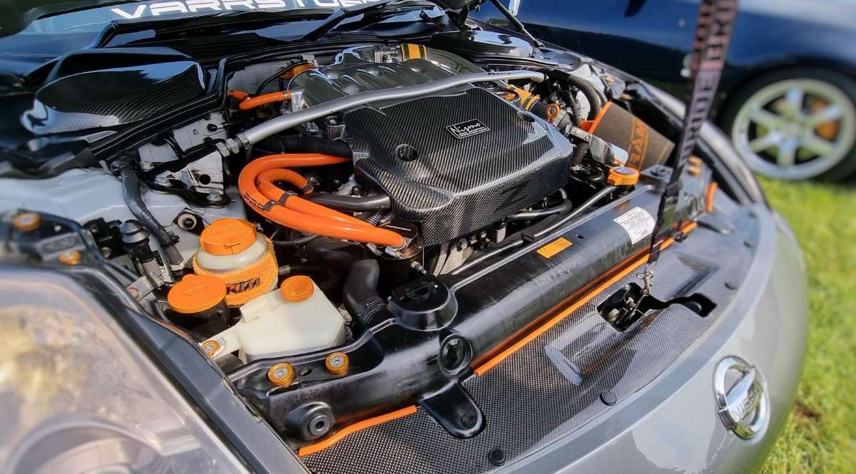

davey_83 Posted June 12, 2023 Share Posted June 12, 2023 Can't beat a bit of carbon in the engine bay, here's my DE also 2 Quote Link to comment Share on other sites More sharing options...
rodgeevans Posted June 12, 2023 Author Share Posted June 12, 2023 (edited) 44 minutes ago, davey_83 said: Can't beat a bit of carbon in the engine bay, here's my DE also No you can't, that's looking good, although I need to sand and relaquer my engine cover to get it back like yours Edited June 12, 2023 by rodgeevans Quote Link to comment Share on other sites More sharing options...
