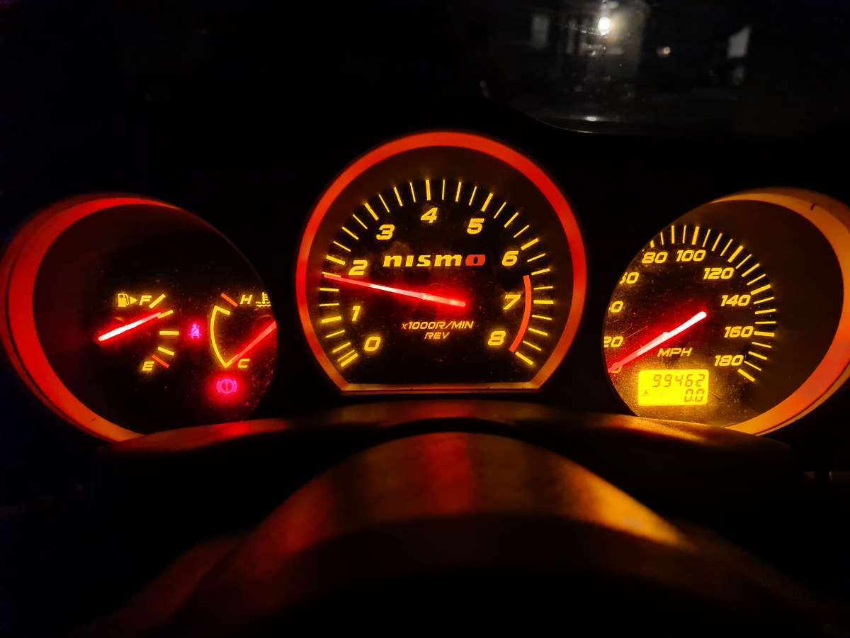

rodgeevans Posted January 26, 2023 Author Share Posted January 26, 2023 (edited) So tried to do a little job today and fix the nismo dials whilst they look great, they don't seem to work correctly, has anyone experienced this before the dials get stuck and don't give a true reading then jump to another value in one quick movement without giving a true reading. This was sitting at tick over which on my car is just below 1k however no matter the revs it didn't change until I gave it some beans driving and it jumped to around 4k, and the whole time I was either going 0 or 40mph according to the speedo https://youtu.be/4gjyfFc4Bc8 Edited January 26, 2023 by rodgeevans Quote Link to comment Share on other sites More sharing options...

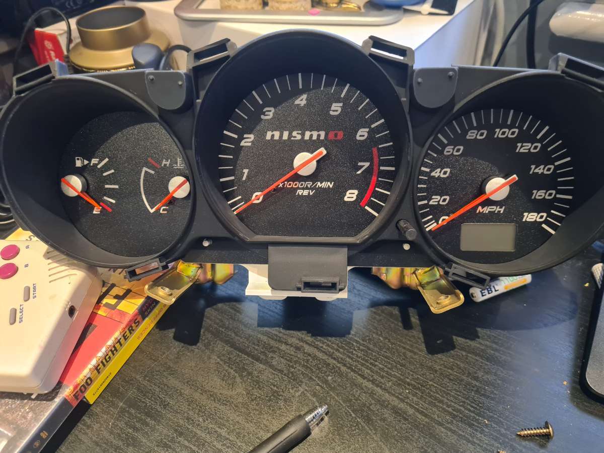

rodgeevans Posted January 27, 2023 Author Share Posted January 27, 2023 So I believe this was due to my car being jdm and the dials being uk, so this morning have stripped them down to swap over the important bit. 2 Quote Link to comment Share on other sites More sharing options...

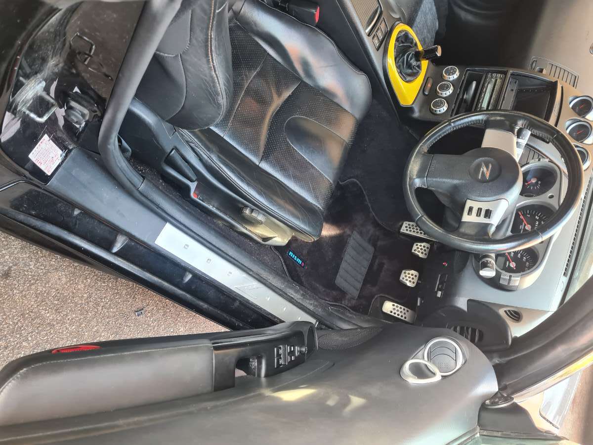

rodgeevans Posted January 27, 2023 Author Share Posted January 27, 2023 (edited) All back together and working correctly, also with added new mats, gear shift and sil plates. All ready now for my latest mid week purchase to arrive, hr centre console/dash and door cards and a deep clean of those carpets as well Edited January 27, 2023 by rodgeevans 1 Quote Link to comment Share on other sites More sharing options...

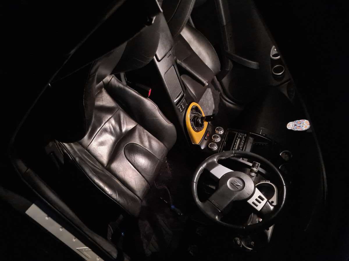

rodgeevans Posted February 3, 2023 Author Share Posted February 3, 2023 (edited) Small teaser picture of the HR interior going in. Going to spray the gear surround silver but it was orange and couldn't have that, but only had yellow to hand. Going to have to get a fresher steering wheel now Edited February 3, 2023 by rodgeevans 1 Quote Link to comment Share on other sites More sharing options...

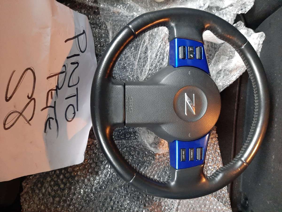

pintopete58 Posted February 3, 2023 Share Posted February 3, 2023 Hi I do have a 350 face-lift steering wheel complete and good condition but switch surrounds are blue but you can paint them to match gear surround Quote Link to comment Share on other sites More sharing options...
rodgeevans Posted February 3, 2023 Author Share Posted February 3, 2023 2 hours ago, pintopete58 said: Hi I do have a 350 face-lift steering wheel complete and good condition but switch surrounds are blue but you can paint them to match gear surround Thanks, but not too different to mine, I did look at the flat bottomed one you had and had it not been for the blue... but I think its a flat bottomed one I'm after, or an aftermarket one Also now fitted one of the door cards but ran out of time to do other side, JDM window switches retained to keep the auto down function on both windows 1 Quote Link to comment Share on other sites More sharing options...
