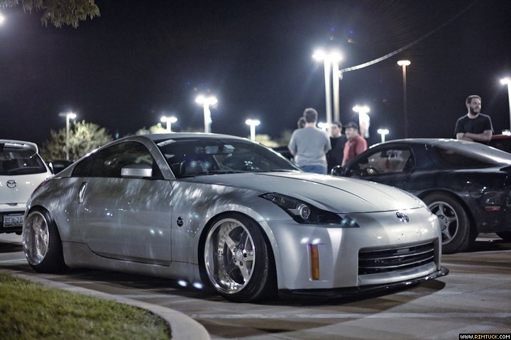

docwra Posted September 20, 2011 Share Posted September 20, 2011 The main reason I want more rubber apart from the fact I hate spacers is thus far I have a Milltec cat-back exhaust plus de-cats and up-rev from Abbey. In addition I am getting a supercharger in a couple of weeks. So I just need some grip for the wet winter. Actualy grip difference between a 265 and a 285 isnt *that* much though ........ I also want to keep the car Stealth. However black is about the only colour wheel that looks good on a silver car. OK ......... I was considering Toyo Proxes as I hear they have good grip in the wet. Plus they are fair bit cheaper that the bridgestones.Something I won't do is compromise on safety. Mine or anyone elses as we all owe each other a duty of care. Get the Bridgies then, the Toyos are good for the money but nowhere near the RE050A's Quote Link to comment Share on other sites More sharing options...

4RE Leather Posted September 20, 2011 Share Posted September 20, 2011 Should have said the only colour apart from the obvious that compliments a Silver car apart from those nice chrome ones is Black. How much were they as the look great. Wonder how much my rays are worth. I even have a brand new one with unused 225/45/18 Potenza so thats five all told. Trouble is with insurance companies they consider larger tyres or Chrome wheels as a mod. then they rub their hands together and proclaim that the wheels make it more knickable and want more dosh! Tell them you have no mods and they send their own assessor to check the car and he sees ya lubbly jubbly shiney's and the swine will berrate you with a barrarge of rules and word plays! The car God demands a sacrifice!! Peter Quote Link to comment Share on other sites More sharing options...
WINKJ Posted September 20, 2011 Share Posted September 20, 2011 WHAT IS THE FRONT LIP ON THIS Z?!? The main reason I want more rubber apart from the fact I hate spacers is thus far I have a Milltec cat-back exhaust plus de-cats and up-rev from Abbey. In addition I am getting a supercharger in a couple of weeks. So I just need some grip for the wet winter. Actualy grip difference between a 265 and a 285 isnt *that* much though ........ I also want to keep the car Stealth. However black is about the only colour wheel that looks good on a silver car. OK ......... I was considering Toyo Proxes as I hear they have good grip in the wet. Plus they are fair bit cheaper that the bridgestones.Something I won't do is compromise on safety. Mine or anyone elses as we all owe each other a duty of care. Get the Bridgies then, the Toyos are good for the money but nowhere near the RE050A's Quote Link to comment Share on other sites More sharing options...
docwra Posted September 20, 2011 Share Posted September 20, 2011 The wheels in that pic are Work Equips, Ive got a pair for sale in fairly similar sizes available if you are interested ....... Tell me about your Rays, model, size, offset, tyres, condition and Ill tell you what they are worth I Quote Link to comment Share on other sites More sharing options...

4RE Leather Posted September 20, 2011 Share Posted September 20, 2011 The wheels in that pic are Work Equips, Ive got a pair for sale in fairly similar sizes available if you are interested ....... Tell me about your Rays, model, size, offset, tyres, condition and Ill tell you what they are worth I They are what ever came out of the factory 18's with one brand spanking new front at tyre 245/45/18 Quote Link to comment Share on other sites More sharing options...
