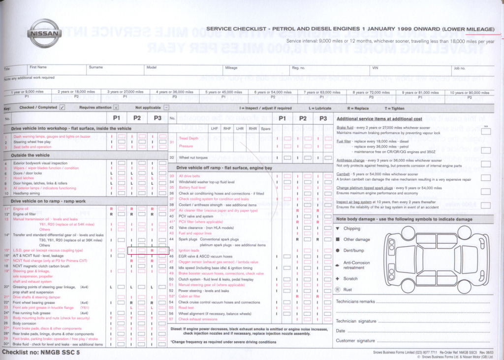

kano Posted August 4, 2011 Share Posted August 4, 2011 Fuel filter every 36k Really? Ah - missed this caviat on the service sheet: "Maintenance free on 350z" Quote Link to comment Share on other sites More sharing options...
kano Posted August 4, 2011 Share Posted August 4, 2011 I just paid around £450 for P3, sparks, brake fluid, diff oil, gear box oil. P2/P3's don't include sparks, brake fluid, gear/diff oil. They do include a brake fluid change - on my service sheet for P2 and P3 its got a big juicy "R" next to "Brake fluid - check for level and leaks", on a P1 its just an "I" for inspect. They use 1L of brake fluid which costs £7. God knows what the quality of that is! Quote Link to comment Share on other sites More sharing options...
Ricey Posted August 4, 2011 Share Posted August 4, 2011 Fuel filter every 36k Really? Ah - missed this caviat on the service sheet: "Maintenance free on 350z" It took me a bit of research when I was preparing for the service........can't understand why you just wouldn't stick an 8 quid replaceable filter on it myself - thats Nissan for you though! Quote Link to comment Share on other sites More sharing options...
Ricey Posted August 4, 2011 Share Posted August 4, 2011 I just paid around £450 for P3, sparks, brake fluid, diff oil, gear box oil. P2/P3's don't include sparks, brake fluid, gear/diff oil. They do include a brake fluid change - on my service sheet for P2 and P3 its got a big juicy "R" next to "Brake fluid - check for level and leaks", on a P1 its just an "I" for inspect. They use 1L of brake fluid which costs £7. God knows what the quality of that is! Fair play.......I'm sure my local Nissan dealer said it wasn't but in honesty I wouldn't put them in charge of a can of baked beans never mind a 350! Quote Link to comment Share on other sites More sharing options...
kano Posted August 4, 2011 Share Posted August 4, 2011 I just paid around £450 for P3, sparks, brake fluid, diff oil, gear box oil. P2/P3's don't include sparks, brake fluid, gear/diff oil. They do include a brake fluid change - on my service sheet for P2 and P3 its got a big juicy "R" next to "Brake fluid - check for level and leaks", on a P1 its just an "I" for inspect. They use 1L of brake fluid which costs £7. God knows what the quality of that is! Fair play.......I'm sure my local Nissan dealer said it wasn't but in honesty I wouldn't put them in charge of a can of baked beans never mind a 350! When my service comes round I'm going to provide them with 1.5L of Motul RBF600, they better not balls it up! Quote Link to comment Share on other sites More sharing options...
Lincolnbaggie Posted August 4, 2011 Share Posted August 4, 2011 I just paid around £450 for P3, sparks, brake fluid, diff oil, gear box oil. P2/P3's don't include sparks, brake fluid, gear/diff oil. They do include a brake fluid change - on my service sheet for P2 and P3 its got a big juicy "R" next to "Brake fluid - check for level and leaks", on a P1 its just an "I" for inspect. They use 1L of brake fluid which costs £7. God knows what the quality of that is! Incorrect I'm afraid - according to the schedule for the 350z on page 18/19 of the service booklet it just has an "I" next to brake fluid for all 3 services. Brake fluid changes are under the additional service items at additional cost to the right side. I think you're looking at the wrong checklist (unless you have a service sheet from somewhere else?) Quote Link to comment Share on other sites More sharing options...
lrh Posted August 4, 2011 Share Posted August 4, 2011 As you can see a P2 is identical to a P3 for a 350Z (viscous diff so no oil change) but they still charge £50+ more Quote Link to comment Share on other sites More sharing options...

kano Posted August 4, 2011 Share Posted August 4, 2011 I just paid around £450 for P3, sparks, brake fluid, diff oil, gear box oil. P2/P3's don't include sparks, brake fluid, gear/diff oil. They do include a brake fluid change - on my service sheet for P2 and P3 its got a big juicy "R" next to "Brake fluid - check for level and leaks", on a P1 its just an "I" for inspect. They use 1L of brake fluid which costs £7. God knows what the quality of that is! Incorrect I'm afraid - according to the schedule for the 350z on page 18/19 of the service booklet it just has an "I" next to brake fluid for all 3 services. Brake fluid changes are under the additional service items at additional cost to the right side. I think you're looking at the wrong checklist [attachment=1]service book.jpg[/attachment] (unless you have a service sheet from somewhere else?) Maybe they've updated the service sheet? This one is from my last service, plus on the invoice I have a payment for 1L of brake fluid, so I'm assuming they've changed the brake fluid and not just topped it up. Edit: It's not in the additional service items area any more. I reckon people weren't changing the fluid so as a safety issue they moved it from additional to mandatory. Quote Link to comment Share on other sites More sharing options...
