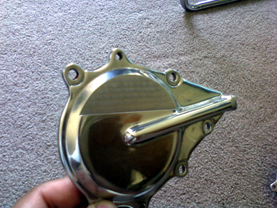

Keyser Posted June 9, 2011 Author Share Posted June 9, 2011 You can get belts can't you? I'm OK Steady gave me a box of bits including a new belt, air filter Berks HFC's etc etc and I just found this on my350z.com with the caption "you have to machine down the cam cover just a tiny bit so the belt doesn't rub against it. use a file if you don't want to deal with pulling the cam cover off" Thanks to the OP for that! Same Mod as is on mine - it also appears my belt is way to lose from the first few bits I have read...... Grub now then more research is required I think. Quote Link to comment Share on other sites More sharing options...

Sam Mcgoo Posted June 9, 2011 Share Posted June 9, 2011 You can get belts can't you? I'm OK Steady gave me a box of bits including a new belt, air filter Berks HFC's etc etc and I just found this on my350z.com [attachment=0]cover2.jpg[/attachment] with the caption "you have to machine down the cam cover just a tiny bit so the belt doesn't rub against it. use a file if you don't want to deal with pulling the cam cover off" Thanks to the OP for that! Same Mod as is on mine - it also appears my belt is way to lose from the first few bits I have read...... Grub now then more research is required I think. I haven't managed to source the belts over here yet. All the places I've been can get sizes either an inch longer or 1/2 inch shorter etc..... If you ever order anything form Vortech or Superchargers online (like belts or your new Pulley ) Then let me know and it'll keep the postage costs down. Yep have your dinner and get reading, I do it every couple of months, especially the Vortech FAQ I hate to think how many hours I've spent reading on there, but every time I do I learn something and find something else to check. Enjoy Quote Link to comment Share on other sites More sharing options...
