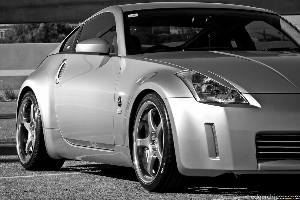

docwra Posted March 24, 2011 Share Posted March 24, 2011 This is 19x9 ET20, standard arch and camber I believe ........... And 19x9 ET -1 (front) with a fair amount of arch work Id personally go with a 9.5 ET10 on the front and a 10 ET0 on the rear, heres my car with 9J ET 20 front and 10J ET15 rear. Quote Link to comment Share on other sites More sharing options...
djrm Posted March 24, 2011 Author Share Posted March 24, 2011 Thanks for the info mate! Very helpful! That black zed makes me think I bought the wrong colour!! Lol... STEALTHY! I dont really want to have to mess about with the arches at all if I can help it... Thanks again, I will stick updates on here as I go Quote Link to comment Share on other sites More sharing options...
