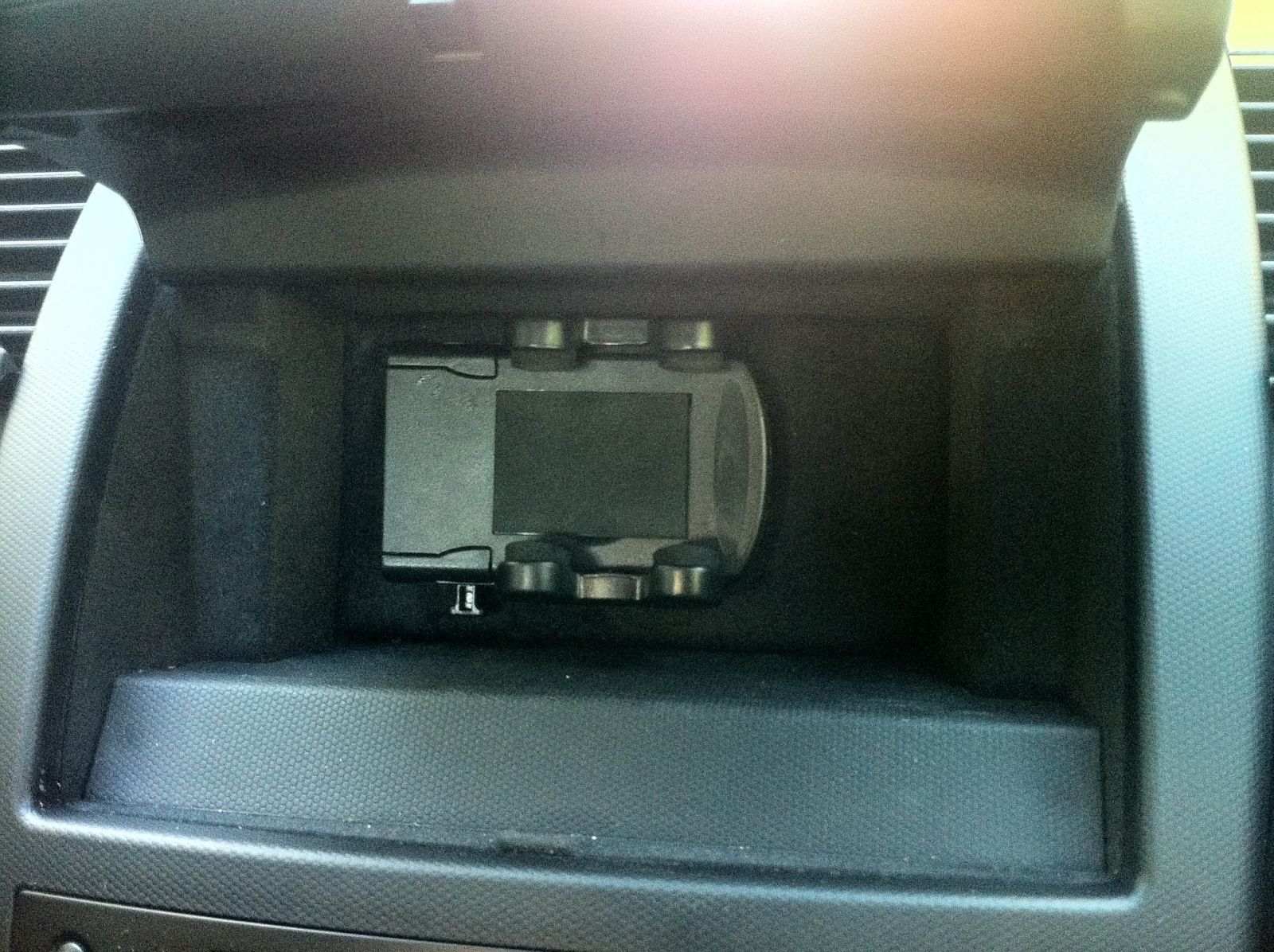

Randy_Baton Posted February 18, 2017 Share Posted February 18, 2017 Easiest thing is to go straight up into the cubby hole. Others have used a longer cable and gone into the arm rest box (where the Bluetooth adapter is). I don't think you have to make any holes yourself, but to go to the arm rest you need to pull up more trim. Plenty of pictures in this thread. There's some in build thread too. 1 Quote Link to comment Share on other sites More sharing options...
Strudul Posted February 18, 2017 Share Posted February 18, 2017 (edited) I usually have my phone stuck to the cubby hole door, so wouldn't want a wire trailing over the handbrake and gearstick to my phone. If there is space for a wire to trail out of the cubby hole with the door closed then that might work. I was thinking more along the lines of through into the passenger footwell next to the 12V outlet. Edited February 18, 2017 by Strudul Quote Link to comment Share on other sites More sharing options...
Randy_Baton Posted February 18, 2017 Share Posted February 18, 2017 I mounted mine inside the cubby hole, don't think 5hefe would be room for a cable. 1 Quote Link to comment Share on other sites More sharing options...

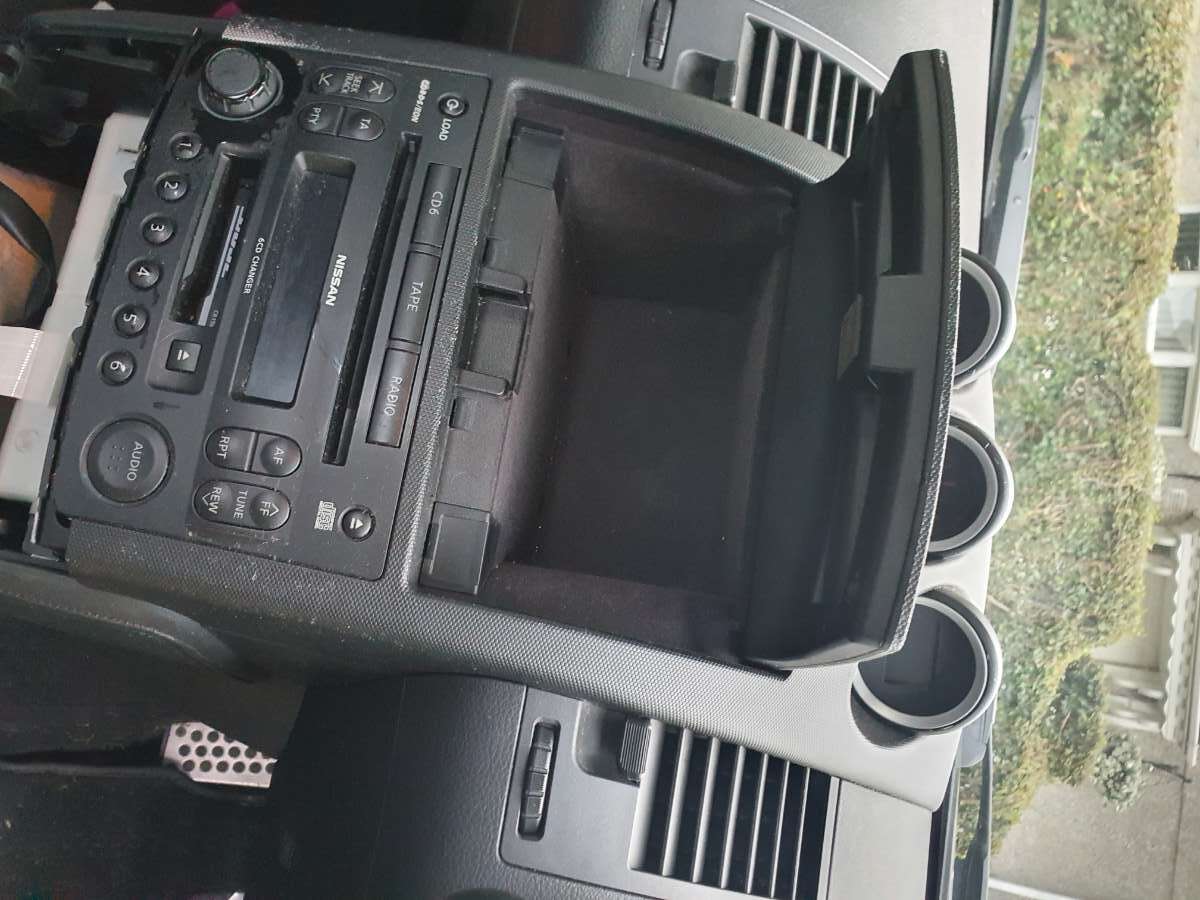

lct Posted September 18, 2022 Share Posted September 18, 2022 So I got to this part and don't appear to have access to any screws? Anyone else face this? Quote Link to comment Share on other sites More sharing options...
Randy_Baton Posted September 18, 2022 Share Posted September 18, 2022 Not seen that before. My guess is that yours is different because it came with the factory sat nav I’d just have a pull on those tabs and see if there are screws behind them Quote Link to comment Share on other sites More sharing options...
lct Posted September 19, 2022 Share Posted September 19, 2022 There's no sat nav mate, I'm scared to pull too much in case I break anything Quote Link to comment Share on other sites More sharing options...
