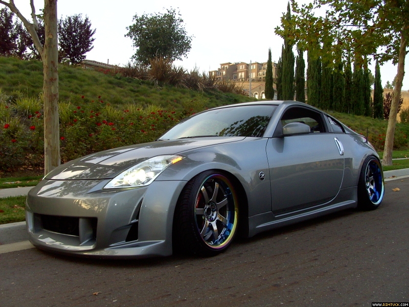

RisingPower Posted January 2, 2011 Share Posted January 2, 2011 If you mean flush, mine are 10.5 et 18 at the back and imho they're pretty much flush. However, filling the arches, 18"s imho won't do that even with lowering but that's just my opinion. Also, if you want to keep the tyre size and be flush, think the standard rays are +33 and 8.5, soooo.... quite large spacers? Ahh, but seeing 9.5 on the back, you'll be running a bit of stretch also on the 245's. For the 8.5/9.5 imho you really want very low offsets to keep it flush, or you could use spacers. http://www.1010tires.com/wheeloffsetcalculator.asp To get 8.5/9.5 in about 9.5 +17/10.5 +18 flush you're talking +4, +5. For ref, imho this is flush enough: I'm sure ian will be along with some hellaflush wheels Quote Link to comment Share on other sites More sharing options...

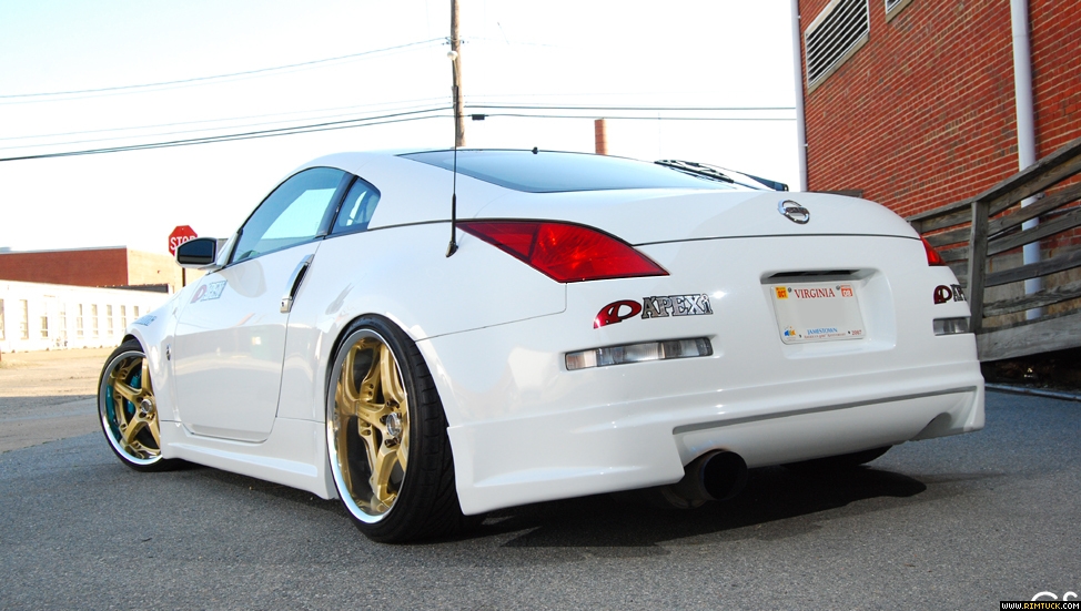

docwra Posted January 20, 2011 Share Posted January 20, 2011 I just posted this actually: 19x9.5 ET0 front, 19x10.5 ET -25 rear 19x9.5 ET0 front, 19x10 ET -25 rear and if you dont like tyre stretch: 19x9.5 +2 with 255 front tyre, 19x10.5 +12 with 275 rear tyre Id be looking at getting to the equivalent of a 9.5 ET5 and 10.5 ET-5 at the very minimum myself. Quote Link to comment Share on other sites More sharing options...

Sam Mcgoo Posted January 20, 2011 Share Posted January 20, 2011 I just posted this actually: 19x9.5 ET0 front, 19x10.5 ET -25 rear 19x9.5 ET0 front, 19x10 ET -25 rear and if you dont like tyre stretch: 19x9.5 +2 with 255 front tyre, 19x10.5 +12 with 275 rear tyre Id be looking at getting to the equivalent of a 9.5 ET5 and 10.5 ET-5 at the very minimum myself. The stance looks very cool, but seriously, do these people drive anywhere or do they have hydraulics or what? Quote Link to comment Share on other sites More sharing options...
RisingPower Posted January 20, 2011 Share Posted January 20, 2011 The stance looks very cool, but seriously, do these people drive anywhere or do they have hydraulics or what? Do they have bumps in virginia? Quote Link to comment Share on other sites More sharing options...
docwra Posted January 21, 2011 Share Posted January 21, 2011 I just posted this actually: Id be looking at getting to the equivalent of a 9.5 ET5 and 10.5 ET-5 at the very minimum myself. Stance whore Mind you, I do like the looks of what appear to be the project kics r26 lug nuts. Dont tell anyone what they costs FFS. The Americans do run much lower than we do, they dont have bumps but the white car isnt any lower than mine I wouldnt have said. I do get near constant grief from proper stance whores that mine is too high, but when it comes to a choice between looking awesome on the drive or actually being able to drive it I know which I prefer. Quote Link to comment Share on other sites More sharing options...
RisingPower Posted January 21, 2011 Share Posted January 21, 2011 Dont tell anyone what they costs FFS. The Americans do run much lower than we do, they dont have bumps but the white car isnt any lower than mine I wouldnt have said. I do get near constant grief from proper stance whores that mine is too high, but when it comes to a choice between looking awesome on the drive or actually being able to drive it I know which I prefer. They're as cheap as chips Especially the neo chros. A few of my oem ones are looking a bit rusty Would muteki be baller enough though compared to kics? With the state of the high street as it is currently, even a 4x4 would bottom out Quote Link to comment Share on other sites More sharing options...
