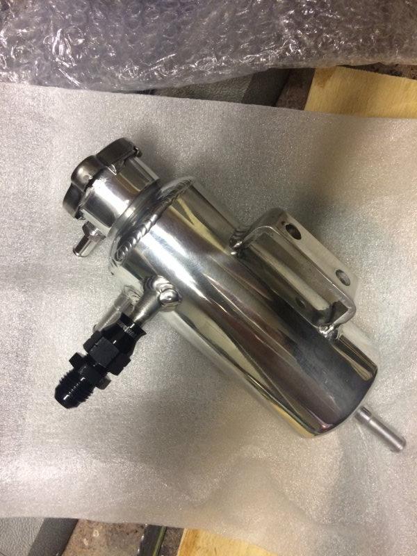

andlid Posted March 10, 2016 Author Share Posted March 10, 2016 Ok, so what happened in here? Nothing much! Other priorities took over. Bought a house last year and almost "Lost" the Z! Managed to hold on but barely and this year looks to be a hard one for the Z... Other news? New Akebonos fitted! (almost) waiting for some rear handbrake items from here actually hoping to get this all sorted this weekend, waiting for this snow to go away too! Started to build my new swirl/header tank pot thingy my jiggy. Will wait and see if this sorts the splurting water issue with APS. Looking to get a custom intake to replace the SSV kinetix mani. | more news to come here shortly I hope. After MOT this year goodies will be installed *I hope... priorities this year is to drive, drive, drive, track! . Quote Link to comment Share on other sites More sharing options...
andlid Posted March 10, 2016 Author Share Posted March 10, 2016 Currently it looks like above, AN fitting to the pipe after some slight modifications. Lower pipe to go to the lower hose on the radiator, one of the top ones from the radiator *previously gone to the expansion tank the other top one will go to the old expansion tank. Hoping to see this improve the splurting, air in the system. The turbo hose will connect to the AN. *if it fits Quote Link to comment Share on other sites More sharing options...

GT4 Zed Posted March 10, 2016 Share Posted March 10, 2016 Wow anders, it's taken you over a year to build s swirl tank mate :lol: Glad you graced us with your presence and update of your journey with the zed 👠Keep it coming.. Quote Link to comment Share on other sites More sharing options...

andlid Posted March 10, 2016 Author Share Posted March 10, 2016 Wow anders, it's taken you over a year to build s swirl tank mate :lol: Glad you graced us with your presence and update of your journey with the zed í ½í± Keep it coming.. Thanks dude, I know mad right lol... slow progress... hahaha Quote Link to comment Share on other sites More sharing options...
