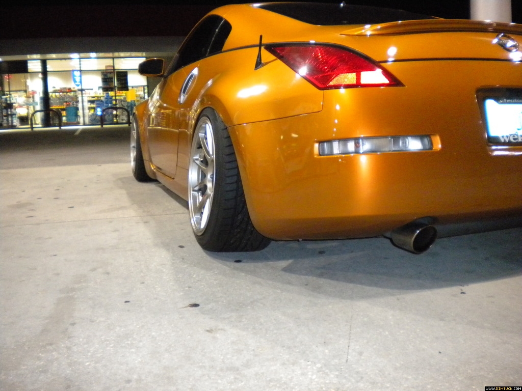

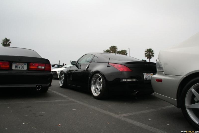

docwra Posted August 19, 2010 Share Posted August 19, 2010 On a standard, unmolested arch I dont think you could go much past 10J ET0. With rolling and flaring you might get another 15mm, so 10J ET -15 or 12 ET10, but Ive not seen it done Id hasten to add. Thats a 19x11 ET4 but I know theres some archwork done there. Thats 18x10.5 ET-8 and looks like its just been lipped, not flared. www.rimtuck.com is your friend BTW, Im running 10 ET -44 but thats with a 65mm arch extension ........... Quote Link to comment Share on other sites More sharing options...
