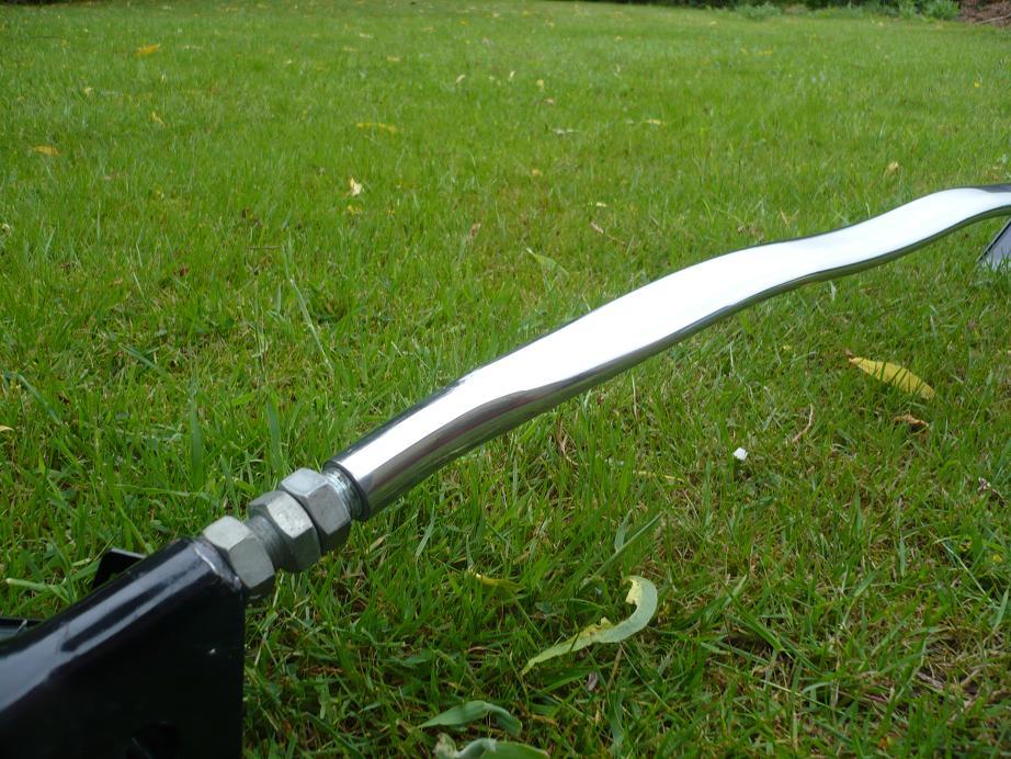

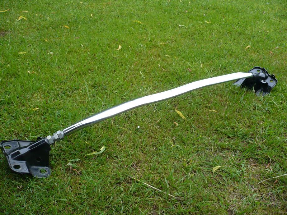

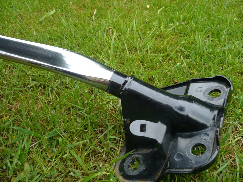

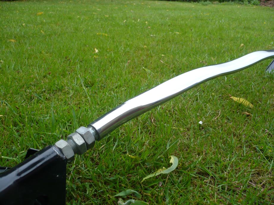

Husky Posted June 8, 2010 Share Posted June 8, 2010 Decided i'd do this Simple really: mask off both sides with duc tape or whatever Use rough paper to remove the silver paint and then the underlying black primer i started with 240 grit and then went through 400 600 800 1200 1500 then autosol and then megs metal polish. now i need to laquer it, i bought petrol resistant laquer but i have no idea what im doing and will prob now ruin it all its steel so you have to REALLY keep it bone dry and away from any water or you will have to start again due to rust crap pics but i will get better ones and then on the car also i didnt have the time to make it perfect so its to an acceptable polish in my eyes. Quote Link to comment Share on other sites More sharing options...

Husky Posted June 10, 2010 Author Share Posted June 10, 2010 ok so took a few pictures in some decent light Quote Link to comment Share on other sites More sharing options...
