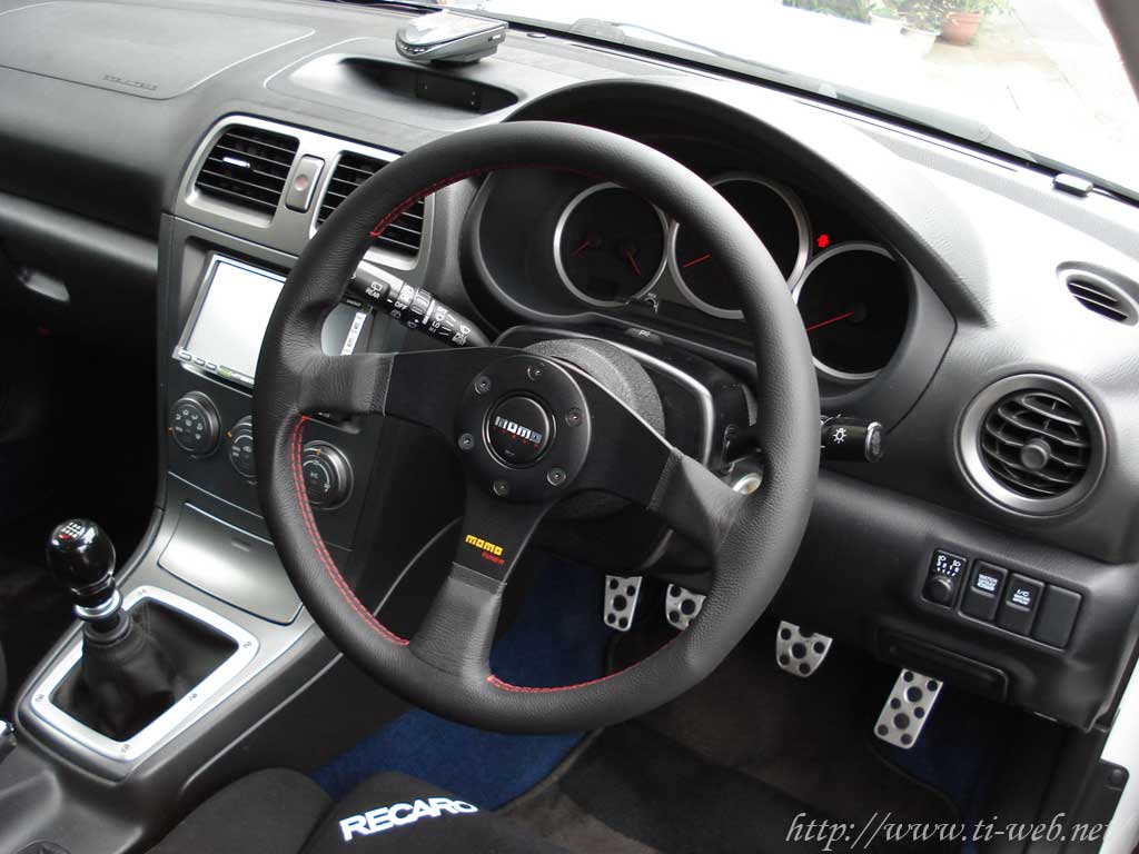

Your wheel does look awesome, thanks for the advice. The stock wheel position is fine, just the diameter is too big - doesn't need to be much smaller either - made that mistake in my MR2. Yours looks spot on.

Ok i did it,
i ordered a momo tuner, like this one..
Had to stop myself from wanting the same wheel as Ian though as it looks very cool :lol:
Should get it next week, i'll get some pics up once it's on :)
I went for the zed fitment momo hub for now, i got a package deal at a good price. I wanted to get the wheel on the car first to get an idea of reach etc, then if the momo hub looks and feels naff i'll know what to do with regards to short hub / long hub, spacers etc.. i have no need for quick release personally, although they do look cool.
