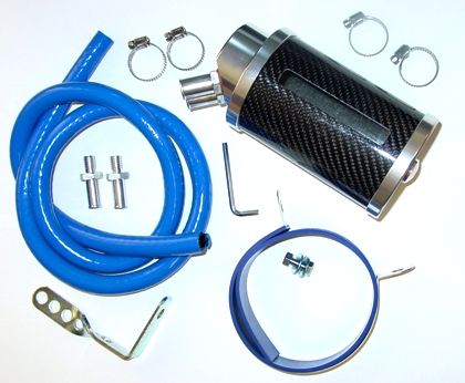

BladesGrant Posted April 29, 2010 Share Posted April 29, 2010 I am looking at this one at the moment priced at £58. Think it looks pretty decent: Quote Link to comment Share on other sites More sharing options...

BladesGrant Posted April 29, 2010 Share Posted April 29, 2010 The only one I have seen with 3 outputs is the ARC which is ££££. I presume its normal for only 2 outputs but the Zed needs 3? Have no idea of the connections for them. Quote Link to comment Share on other sites More sharing options...
srobrien Posted April 29, 2010 Author Share Posted April 29, 2010 I think 2 is fine...ive just gone for the cusco. R Quote Link to comment Share on other sites More sharing options...
Ian Posted April 29, 2010 Share Posted April 29, 2010 2 is fine, it just won't connect to the intake aswell No need for any t-pieces as you remove a pipe that runs between 2 ports & plug a cable into each Quote Link to comment Share on other sites More sharing options...
yokomo Posted April 29, 2010 Share Posted April 29, 2010 ah so it can be done wiht just 2 connections , does it need a breather aswell ? Quote Link to comment Share on other sites More sharing options...
BladesGrant Posted April 29, 2010 Share Posted April 29, 2010 Whats the difference if it doesn't connect to the intake? Or maybe the question should be whats the benefit of connecting to the intake? Quote Link to comment Share on other sites More sharing options...
Ian Posted April 29, 2010 Share Posted April 29, 2010 ah so it can be done wiht just 2 connections , does it need a breather aswell ? Yes and no I've run both Cusco and ARC Cusco ARC To install the cusco, remove this pipe Then run a hose from each connector to the cusco can. The ARC can only uses one of those hoses, so you block the other one off. Then there is a hose that runs from the underside of the intake pipe to the back of the engine block - remove this & then a hose into the back of the engine & another into the intake pipe Quote Link to comment Share on other sites More sharing options...

yokomo Posted April 29, 2010 Share Posted April 29, 2010 so the cusco only connects to one cylinder head ? if that works ok then it sa pretty simple install . Quote Link to comment Share on other sites More sharing options...
