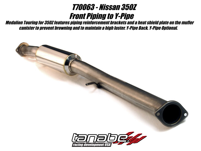

ive got a k1 (although really really tempted to trade in - damnnnnnnnn vibrations and 2-3k rev noise) BUT what actually is the purpose of the Y Pipe?
Connects the 2 cats to the single mid pipe which then connects to the back box.
Unless you go for a true dual system which has 2 mid pipes connecting to 2 cans at the end instead of a back box.
