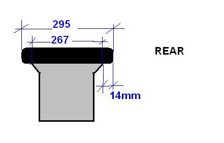

Husky Posted March 25, 2010 Author Share Posted March 25, 2010 for the front are 265's ok? basically the way i see it is... (guesswork) if i have 10.5 wide rims at the back thats 267mm wide. with 295mm wide tyres makes a rough overhang of 14mm (28mm/2) so if i have 9.5 (241mm) wide rims at the front to get the tyres to sit in the same way as the back. 265mm wide tyres will create a 12mm (24/2) overhang, similar to the back. if i do what others have and go for a 245 at the front that means the front will sit flush meaning the back and front wont match. so two solutions to keep them matching, go up to 265 on the front or go down to 275 at the back. can anyone tell me if im talking utter rubbish? dont know if this random paint drawing i have done helps... i suppose by overhang i mean sidewall bulge Quote Link to comment Share on other sites More sharing options...
ATTAK Z Posted March 25, 2010 Share Posted March 25, 2010 for the front are 265's ok? basically the way i see it is... (guesswork) if i have 10.5 wide rims at the back thats 267mm wide. with 295mm wide tyres makes a rough overhang of 14mm (28mm/2) so if i have 9.5 (241mm) wide rims at the front to get the tyres to sit in the same way as the back. 265mm wide tyres will create a 12mm (24/2) overhang, similar to the back. if i do what others have and go for a 245 at the front that means the front will sit flush meaning the back and front wont match. so two solutions to keep them matching, go up to 265 on the front or go down to 275 at the back. can anyone tell me if im talking utter rubbish? dont know if this random paint drawing i have done helps... i suppose by overhang i mean sidewall bulge [attachment=0]rim.JPG[/attachment] That's seems to be extremely clear to me but I am reading this upside down Quote Link to comment Share on other sites More sharing options...

GT4 Zed Posted March 26, 2010 Share Posted March 26, 2010 Hi John, just saw this now if not i would have come to your aid a longtime ago This is my forte you know From what i gather you want to go 19": 19x 9.5 in front and 19x 10.5 at rears your question is what offsets to go for and what tyre size to get the flushed look correct and at the same time having a matched front to rear visual profile correct this is easy and this is what i tried to explain mucho times when getting partworns for peolpe here Anyway tell me if this is correct and we will take it from there My advice in anycase will be 245/35/19 on 19x9.5 in front and 295/30/19 on 19x10.5. A wider front tyre - 265/30/19 will also be fine and more front end grip but is not necessary to potter around like you do . What you need to clarify is if you are planning lowering or not As this will determine how aggresive you want to be on the ET or the tyre or both! 245/35/19 and 275-285/30/ will be great on 9 and 10" wide wheels and not have any issues if the car is left OEM height! you also can go uber aggresive on the ET as you have more leeway Also if you have to decide if you will be prepareed to roll the arch or get least rear camber/toe adjustability. Have a look at this for an example of how aggressive you can go and keep the profile visually matched in a stock car FYI those wheels are 18x9.5 with ET12 front and rear but tyres are staggered 245/45/18 and 275/40/18. He could have gone with thinner profile if he wanted. i still think that lowering wil pull the look off better viewtopic.php?f=61&t=34287 Quote Link to comment Share on other sites More sharing options...
