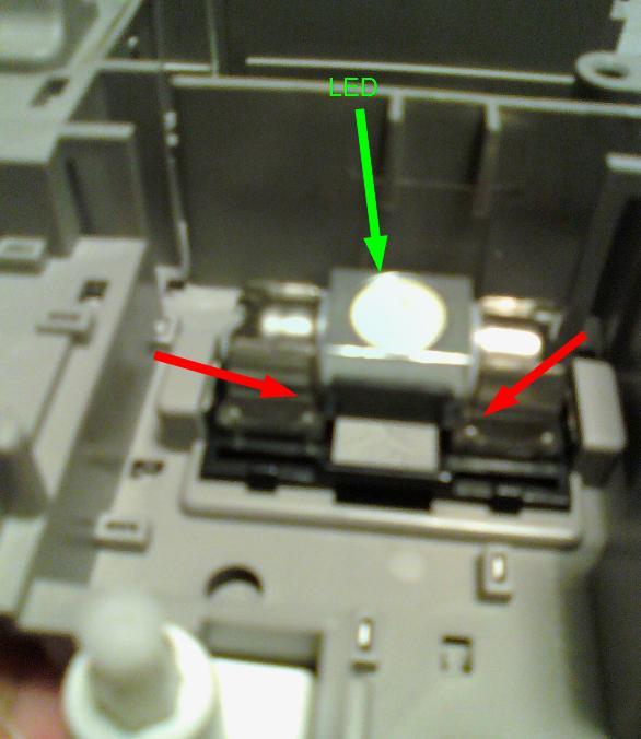

figured out why my dome lights no longer worked, after going throgh aver fuse i pulled it apart, very easy and found the problem
the LED body which is a block of metal acting as a heat sink for the LED, bridged between the two contacts marked in red. shorting the circuit and stopping it from working.
so my advice is make sure you dont rotate the led if you have these, have them at an angle where they do not contact the clips. :thumbs:

these are indeed the dome lights on the roof interior behind the sunglasses holder the reson they work on the button is that it is a different circuit powered by a black and red wire, whereas the door bit is from the pink and red wires :thumbs:
no its definately a short circuit, the metal body contacts the two clips very easily

Guys, please be carefuly dicking about with the dome light. Trust me I learnt the hard way. Shorting the circuit can send a jolt back to the BCM and completely fook it up. I did this trying to work out the wiring for the footwell lights, burnt out the dome lights and ballsed up the BCM. Fortunately, I took it to Nissan saying it just decided to die when the dash lights all went out, and under warrenty they replaced the dome lights (£100+) and the BCM (£500+). I dont want this to happen to you too! :surrender:

This is the reason my dome lights are not fading becuase I was playing around to get the some nice footwell lights in and this shorted a fuse and the rest is history !!!!!
