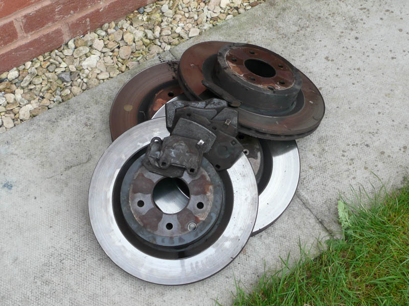

Alpinestar Posted September 6, 2009 Author Share Posted September 6, 2009 For Sale. A pile of old tat. Any offer considered Quote Link to comment Share on other sites More sharing options...

BulletMagnet Posted September 25, 2009 Share Posted September 25, 2009 For Sale. A pile of old tat. Any offer considered [attachment=0]P1000932.JPG[/attachment] You should sell them on eBay as "350Z enthusiast Brembo paperweight / doorstoppers" Quote Link to comment Share on other sites More sharing options...
Alpinestar Posted September 27, 2009 Author Share Posted September 27, 2009 dapsfo1, sorry mate, they were pretty mashed up so I took them to the tip Quote Link to comment Share on other sites More sharing options...
