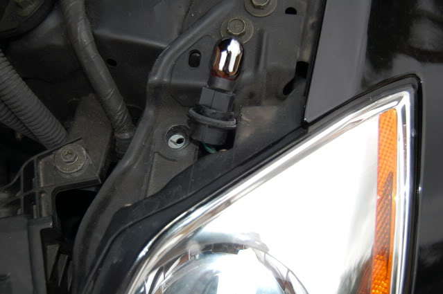

hbwold Posted August 24, 2009 Share Posted August 24, 2009 Replaced the standard 350z front indicator bulbs today. Very easy modification and looks much better, it does help if you have small hands as the space is quite tight. Replaced with these purchased from here: http://www.jdmperformance.co.uk/item_de ... odID=52189 First step to changing these is to open the bonnet, then at the top of the headlight there is a 10mm bolt, remove the bolt This enables you to move the headlight slightly forwards to give you some more space to access the bulb holder shown here Turn the bulb holder slightly and it should free up and easily pull out of the housing in the headlight, then manoeuvre the bulb and holder out though the space where you access the bulb Pull out the old bulb, then push in the new one. Then test the bulb to make sure if functions. If it works then pass the bulb back through the access space, then into the headlight and position the bulb holder until it slots in, then turn until it engages into the headlight and feels solid. Then screw the 10mm bolt back in and you're done! 2 Quote Link to comment Share on other sites More sharing options...

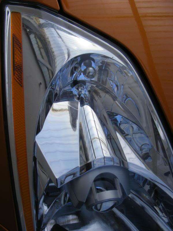

schift Posted October 23, 2009 Share Posted October 23, 2009 I just finished installing these, so I thought I would contribute BEFORE AFTER Quote Link to comment Share on other sites More sharing options...
hbwold Posted October 27, 2009 Author Share Posted October 27, 2009 Good job, looks much better. Also that is one very immaculate front end! Quote Link to comment Share on other sites More sharing options...
bronzee Posted October 28, 2009 Share Posted October 28, 2009 Nice first post by the way schift. Looks great!! Quote Link to comment Share on other sites More sharing options...
