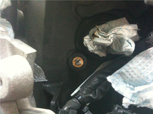

guys n gals, big problem.
i was changing the spark plugs and got through 3 of them. on the fourth one the bolt attaching the coil pack to the rocker cover sheared, there is a tiny nub sitting proud of the rocker cover. tried cutting a slot into it with a dremel and using a screwdriver but it didnt do it, the metal just sheared. anyone got any ideas how i sort it?
or anyone got any bright ideas or equipment to get the bolt out? tried drilling it out using the dremel drill bit but it didnt cut the mustard.
Usual option would be to drill it out and then re tap it. Sounds like you need a drill wiu more oomph. And a proper metal cutting drill bit.
Option to is to weld something to the stump and use that to remove it. But this method is partically dodgy if your crap at welding as you dint want to weld the outside of the rocker cover to the stump of bolt.
You may have drilled out to much by now but drilling a hole in the center and using an easy out should work okay. If you can't get up close and intimate then remove the cover and do it on the bench. If you **** up don't worry as I have spare covers.

is there enough bolt sticking out of the top to get some vice grip pliers onto it. if you can get them locker on they should get it out coz it shouldnt be really tight.
if not if there is a ridge in the top or where you have cut the groove try tapping the bolt around using a screw driver but a centre punch would be better if you had one.
although easy outs should work failing everything else.
or you can drill down the bolt just smaller than the diameter of the bolt and it will come out easy then

cheers for the tips but unfortunatley
only about a thread showing on the top, not enough for grips, tried
tried with the screwdriver, doesnt budge and it will damage the brass insert it sits in.
dont have any easy outs.
tried drilling it, would need a manlier drill and bits which i dont have in england with me :thumbdown:
so before i did any more damage to the car i decided just to order a new cover from alex :thumbs:
