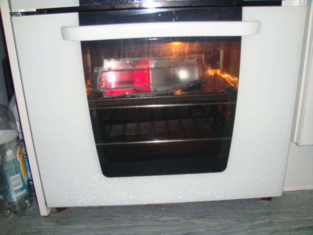

Bundus Posted June 18, 2009 Share Posted June 18, 2009 Honestly guys I found this the easiest mod ive done. Just be really on top of things when you have it in the oven. Put it in for a minutetwo then take it out and try to seperat the lense. Youll find it will part a little bit and the glue will stretch then it will get cold and stop. Put it back in for a minute or two then try again doing a bit at a time. Im sure if you put it in for the full time it would seperate first time but at least this way you dont run the risk of burning anything or melting plastics. Thanks for the guide - worked a treat Quote Link to comment Share on other sites More sharing options...

Danny 350Z Posted July 25, 2009 Share Posted July 25, 2009 As i'm currently on Euro lighting, I had my Fog already to hand. So, with an afternoon to kill, I took the plunge. Quite an enjoyable little mod TBH After srobrien's mishap, I was checking the light every minute. The silcone works its way free gradually. Quite chuffed with the end result. Quote Link to comment Share on other sites More sharing options...

Pimm Posted August 6, 2009 Share Posted August 6, 2009 Danny 350Z said: As i'm currently on Euro lighting, I had my Fog already to hand. So, with an afternoon to kill, I took the plunge. Quite an enjoyable little mod TBH After srobrien's mishap, I was checking the light every minute. The silcone works its way free gradually. Quite chuffed with the end result. Hi Danny, just a quick question mate, did you just push the 2 bits of the indicator back together or did you put new silicone around the edges ? This i might attempt this weekend. Quote Link to comment Share on other sites More sharing options...
T2JOU Posted August 6, 2009 Author Share Posted August 6, 2009 If you heat it up again after pushing it back together the original glue will hold it fine. I used silicone as I wanted to make doubley sure the light wouldn't get moisture in and fog up. Quote Link to comment Share on other sites More sharing options...
Danny 350Z Posted August 6, 2009 Share Posted August 6, 2009 Pimm, there was plenty of blue silicone to just re-meld the parts together after. Quote Link to comment Share on other sites More sharing options...
