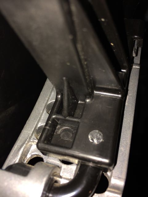

Oversteer Posted March 1, 2016 Share Posted March 1, 2016 (edited) Fitted mine today! I also found getting the plastic securing piece off the original pedal to be a bit of a mind-boggle, but realised that the whole plastic section is one piece - the clip that one prizes off with the screwdriver is a very small part of a much larger plastic 'block' - I couldn't get perspective so took a load of pictures, these may be useful to someone fitting in the future: Top bit, clips around the square section of the pedal (clip is part of the whole plastic structure!) View from looking up at the outside half of the plastic clipping over the metal square bit at the top ('wiggle it') Bottom half of the plastic piece; this clips out easily once the more tricky 'wedge' clips at the top are released New pedal clipped in at the top - it clips in very easily (took this to convince myself it was actually clipped in properly!) Bottom section - just squeeze and hear/feel 2 slight clicks as bottom half clicks in to place Looking forward to the commute tomorrow Edited March 1, 2016 by Oversteer Quote Link to comment Share on other sites More sharing options...
