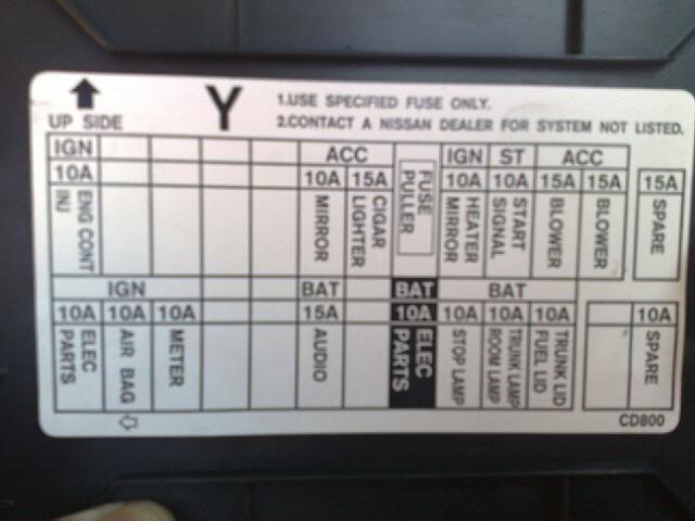

cmmd11483 Posted June 16, 2009 Share Posted June 16, 2009 Note if you have the BOSE with sub there is two 15A fuses marked audio. One is for the headunit and speaker amp the other is for the sub amp. If your sub has stopped working you should hear a bong sound when you first start the car, this is to signify the sub amp fuse has blown. Took me a while to figure out why my BOSE sub wasn't working till I found a copy of the wiring diagram which highlighted the fuse. Quote Link to comment Share on other sites More sharing options...
penfolduk Posted April 17, 2010 Share Posted April 17, 2010 what does it when you a BING BONG 20 secs after starting car??? Quote Link to comment Share on other sites More sharing options...
dcash5 Posted April 23, 2010 Author Share Posted April 23, 2010 Means a component of your satnav system is disconnected or you are due a service and its displayed what service you need on your nav screen Quote Link to comment Share on other sites More sharing options...
Dene8 Posted April 23, 2010 Share Posted April 23, 2010 Note if you have the BOSE with sub there is two 15A fuses marked audio. One is for the headunit and speaker amp the other is for the sub amp. If your sub has stopped working you should hear a bong sound when you first start the car, this is to signify the sub amp fuse has blown. Took me a while to figure out why my BOSE sub wasn't working till I found a copy of the wiring diagram which highlighted the fuse. This could be the reason my sub has stopped working, i'll investigate on my lunch Quote Link to comment Share on other sites More sharing options...
