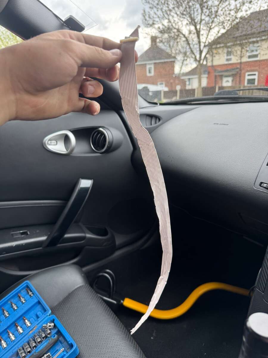

Brandon Moorhouse Posted Monday at 15:35 Share Posted Monday at 15:35 Hi all! 2007 350z HR I recently tried installing an aftermarket steering wheel and in the process of taking off the OEM steering wheel I've snapped off part of what I thinks the clock spring and ripped the long spiral cable, now traction and ESP lights are constantly on and sometimes my break lock up before displaying the lights. Done some digging and it seems I need to re calibrate my steering angle sensor and I don't think I'm any progress with it so any help is appreciated, Thanks! Pics are below Quote Link to comment Share on other sites More sharing options...
Coz@TORQEN Posted Monday at 15:54 Share Posted Monday at 15:54 Have you bought a replacement? If not, judging by the way it's snapped, it's likely you'll need to. If so, pop us a PM with your VIN so I can shoot you a link over to the correct one for your car. Quote Link to comment Share on other sites More sharing options...
