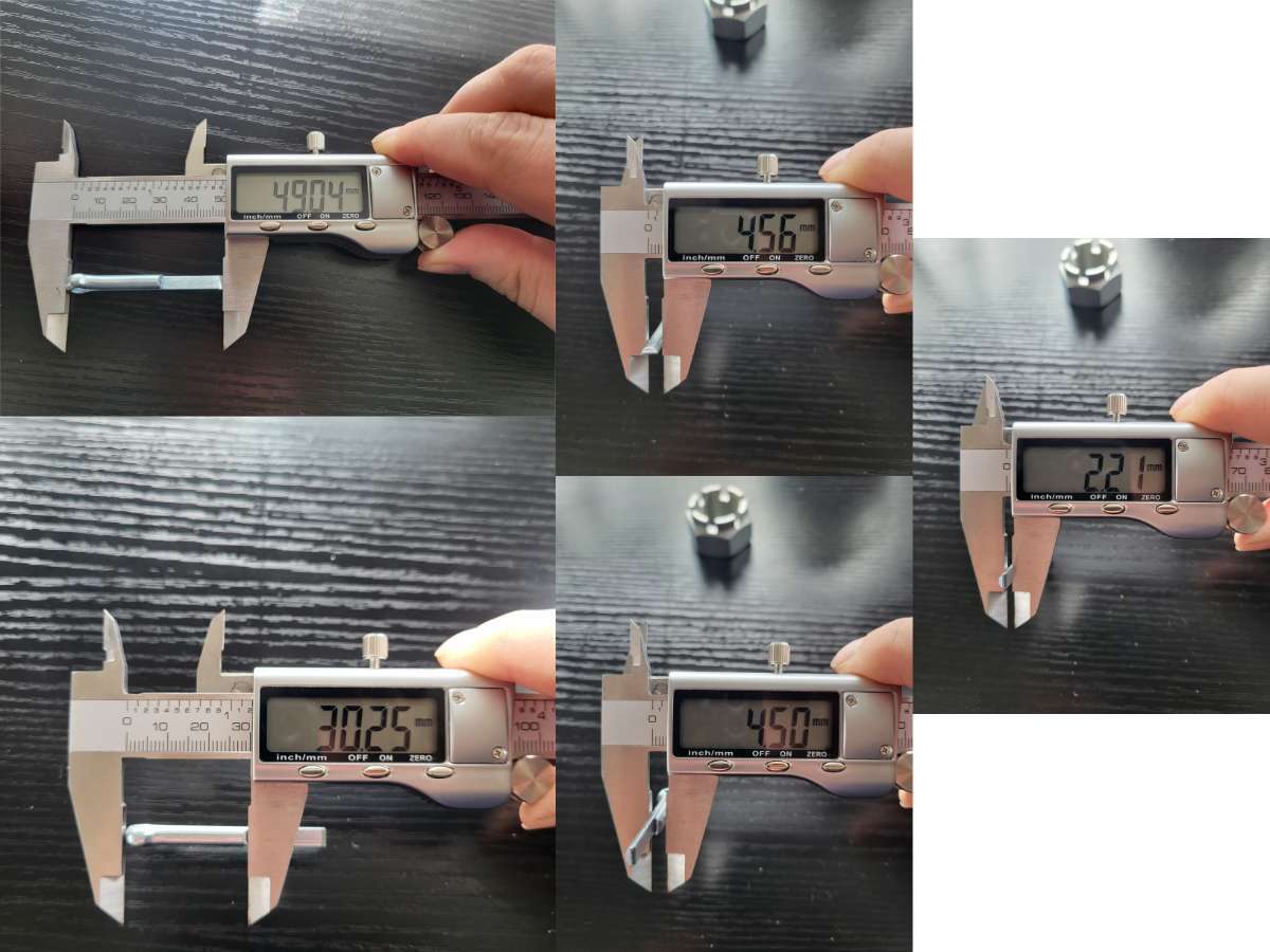

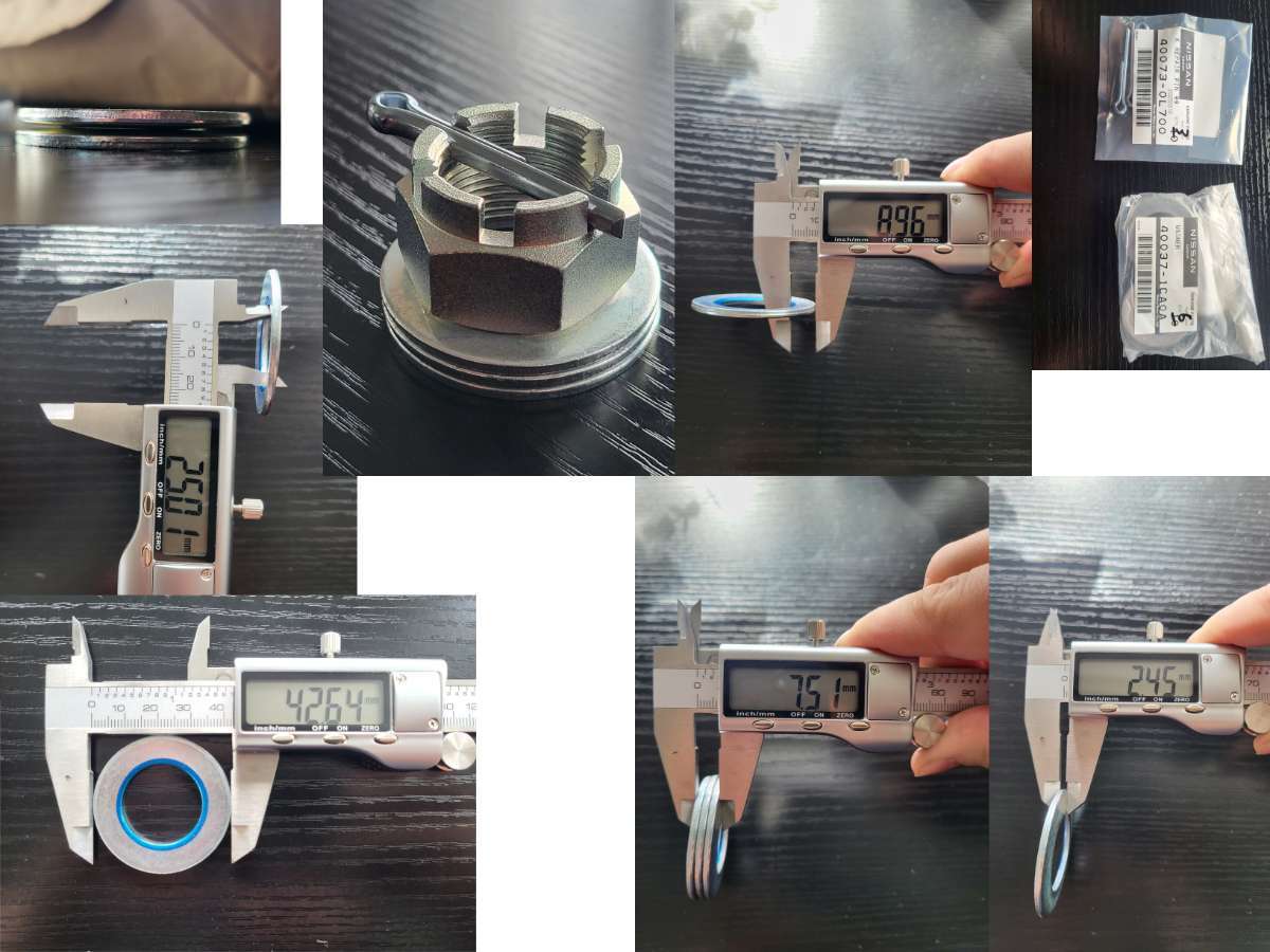

Got the delivery from Japan already, that was quick. I measured the washer and the pin for reference because I couldn't find any info myself (I guess so you pay much more instead of getting a substitute). Mind the spring washers are slightly domed, not flat. I hope its going to be useful to someone in the future:
washer.jpg.2025c1b18ef080102dbde40554e8eded.jpgpin.jpg.1f5617adf92067cdbfbeafa7a988d903.jpg
